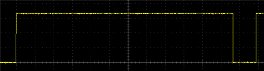

    Confirmed with the ROM code that no changes were done to PRG0_PRU1_GPO12/ PADCONFIG120 (as shown in the below image) during the entire boot process, so we suspect that there might be an issue due to some other reason and would request you to capture the SPI signals corresponding to the images loaded and time taken.
    Trupthi
    I pictured Y4 and Flash Chip select (OSPI0_CSn0), with white arrows indicating same points of application.

    Erik tested with a 10k Ohm pull-up resistor and saw the pin pulled low at power-up in GPMC NOR mode on his digital analyzer. I confirmed the same on my bench with an oscilloscope. SPI mode showed no activity on the scope, but GPMC NOR mode consistently pulls the signal low shortly after power-up (refer to scope shot images).
    Since this occurs only in GPMC boot and not SPI, it’s likely the customer is mistakenly in the wrong boot mode. Given SPI and GPMC configurations are reversed BOOTMODE6:3 (SPI) 0011 vs (GPMC NOR) 1100, we should verify the customer’s boot mode before proceeding.
    We will need the schematics to verify the configuration.
    Sreenivasa
    I was confusing SPI boot with GPMC NOR boot.
    I didn't notice this because my board still works in GPMC boot mode.
    Thank you for identifying the cause of this issue.
