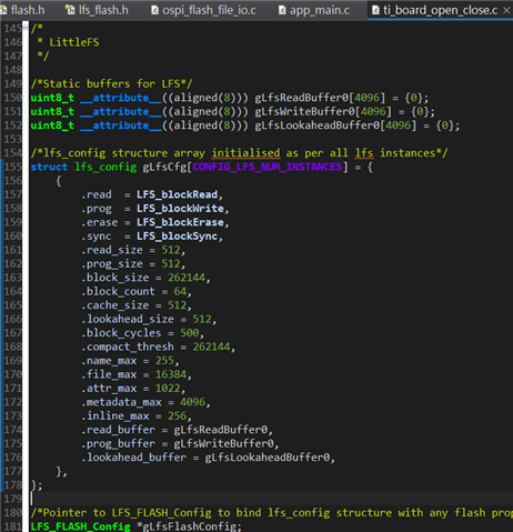

  • Hi Tushar,
    I may have caused some confusion earlier.

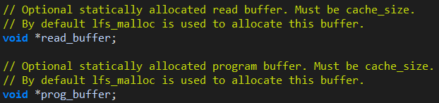

    I mean that the buffer sizes of gLfsReadBuffer0, gLfsWriteBuffer0, and gLfsLookaheadBuffer0 do not change based on the values of .cache_size and .lookahead_size.
    Harry Chu

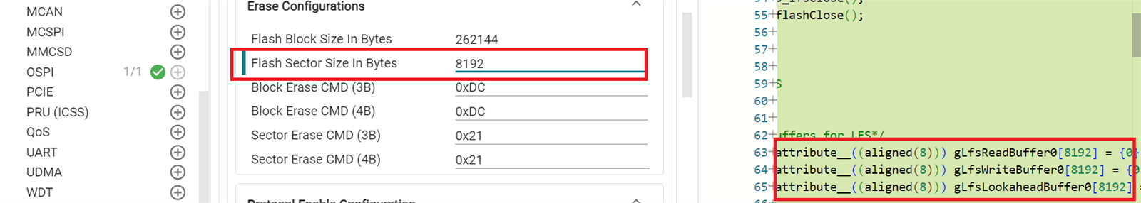

  • Hi Harry,
    I have checked the SDK code and it seems that the size of above mentioned buffer depends on the read sector size of Flash.
    Please refer below image.
    Tushar
  • Hi Tushar,
    This does indeed change the size of these buffers, but it's still not based on .cache_size and .lookahead_size. I think there might be an issue here.

  • Hi Harry,
    Does the size of buffer depends on the .cache_size and .lookahead_size variable? I don't think this is the case here and in the SDK also we are not calculating the size of those buffers based on cache_size or lookahead_size.

  • Hi Tushar,
    This comment comes from lfs.h, which I believe is correct. Since these are optional statically allocated buffers, perhaps an option could be provided to disable them.

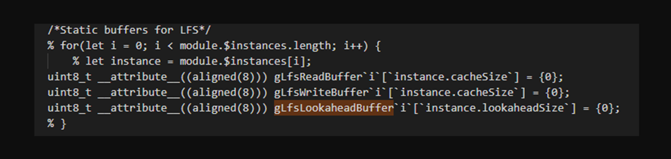

  • Hi Harry,
    To update the read and write buffers according to the value configured in
    You can do the following change in the littlefs_open_close_config.c.xdt file located at ${MCU+SDK}/source/sysconfig/fs/.meta/littlefs/templates.
    Tushar
