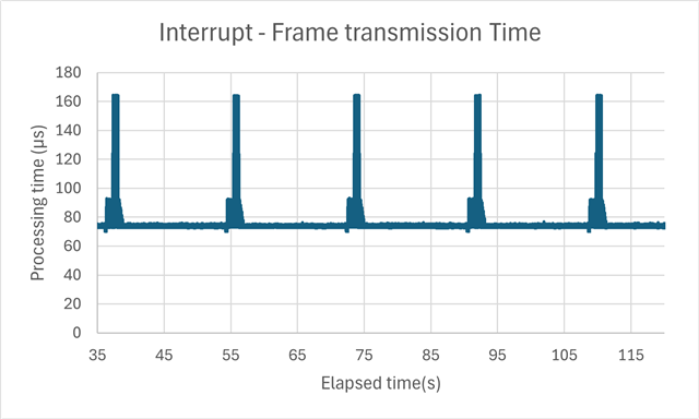

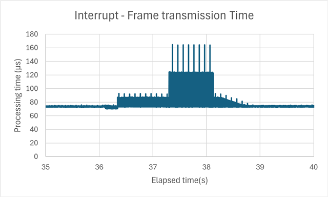

There are no problems with sending and receiving frames, but I found that a delay of about 2s occurs about every 16s.
The measurement was done using the ECAP module from the 500μs interrupt to measure the time when the frame was actually sent from the PHY.
As a result, although it usually takes about 70μs to send, a delay of 90~120μs occurs about 2s every 16s.

  • Hi Kazushige,
    Disabling cache operations during runtime is not a suggested call just to retrieve a small segment of memory. Instead, to retrieve the latest data from another module, it is preferable to use writeback and invalidate calls.
    But I don't see a reason why it would cause an additional latency of 120 us for a prolonged 2 seconds periodically. Let me check internally if we can reproduce it internally, or review places which could cause such issues.
    Please provide more details on various cases of reproducibility. Let us know if this issue is seen on out-of-box example, made to stream packets, or any other ways to reproduce the issue you are observing.
    Teja.
