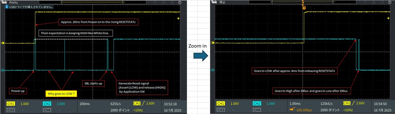

My customer has a problem on GPIO of AM2432 ALX package.
They have implemented the warm reset circuit with GPIO for the Ethernet PHY (DP83822) referring to the schematics of TI LaunchPad_PROC109E3. However, the behaviors of GPIO0_63 (Pin Y4) at power-on are different from their expectation.
Please see the attached waveform observed by the oscilloscope.
CH1 (Yellow) : RESETSTATz,    CH2 (Blue) : GPIO0_63 (Pin Y4)
1.  After power-up, pin Y4 goes to High because there is the pull-up register.
2.  But it goes down to Low after approx. 4ms from releasing RESETSTATz.
3.  After that, it goes to High after 200us, and goes down to Low after 100us.
4.  After 500 ms, it changes Low -> High -> Low.
5.  When the secondary bootloader starts, it changes from low to high again.
6.  The application software controls GPIO0_63 (Pin Y4) to reset the PHY (High -> Low -> High).
The behaviors are that the GPIO pin goes Low (twice) after resetting.
Could you let them know the reason why this behavior occurred ?

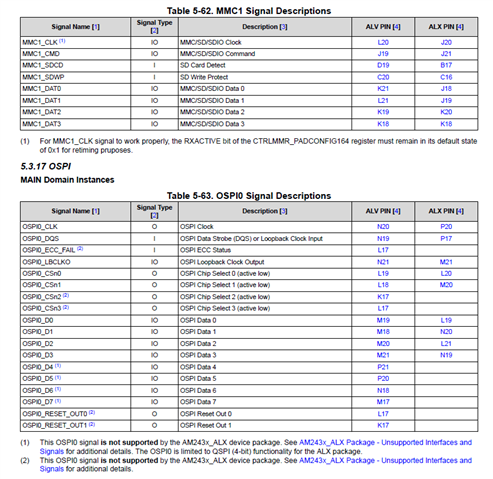

  • Hi Hideaki-san,
    Firstly, as per the AM243x datasheet manual, PIN Y4 is not connected to GPIO0_63 as shown below.
    Secondly, I've confirmed with the ROM code that no changes were done to PIN Y4/ PRG0_PRU1_GPO12/ PADCONFIG120 (as shown in the image) during the entire boot process
    Trupthi
  • Hello Trupti,
    Thank you for replying.
    I suspect you may be looking at AM64x.
    Please refer to AM2432 and the ALX package.
    Pls refer below capture
    Can you pls verify the AM243x rom code (for ALX, in case ROM code is different)
    Sreenivasa

  • Hello Trupti,
    Thank you.
    Example signal description:
    FYI, please refer the signal description capture where the pin mapping changes for the packages.
    Sreenivasa
  • Hi Trupti,
    Thank you for confirming the RBL.
    As Sreenivasa mentioned, I guess that the RBL of AM243x ALX is different from that of AM64x ALV, because the pin configuration is quite different between ALV and ALX like below.
    Could you verify the ROM code of AM243x ALX ?
    Thanks and regards,
    Hideaki

  • Hello Hideaki
    Please refer additional analysis that has been done internally.
    Erik tested with a 10k Ohm pull-up resistor and saw the pin pulled low at power-up in GPMC NOR mode on his digital analyzer. I confirmed the same on my bench with an oscilloscope. SPI mode showed no activity on the scope, but GPMC NOR mode consistently pulls the signal low shortly after power-up (refer to scope shot images).
    Since this occurs only in GPMC boot and not SPI, it’s likely the customer is mistakenly in the wrong boot mode. Given SPI and GPMC configurations are reversed BOOTMODE6:3 (SPI) 0011 vs (GPMC NOR) 1100, we should verify the customer’s boot mode before proceeding.
    We will need the schematics to verify the configuration.
    Sreenivasa
