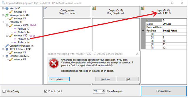

I'm trying to send cyclic data from the Adapter to Scanner software[EnIPExplorer].
Created Assembly object with Instance Id 0x65 and added
Class ID => 0x70 : Instance ID => 0x1 :  ID => 0x308 to 0x30D => as assembly member under the assembly instance 0x65
EI_API_CIP_addAssemblyMember(pCipNode, 0x65, 0x70, 0x1, (uint16_t)(0x308));
which is an Input assembly [T -> O].
Under EI_APP_GENERIC_DEVICE_run(), tried two approaches for sending cyclic data
1. EI_API_CIP_setAttr_usint(pCipNode, 0x70, 0x01, 0x0308, attrValue);  => default
2. EI_API_CIP_getAssemblySize(pCipNode, 0x65, &size);
      EI_API_CIP_setAssemblyData (pCipNode, 0x65, &attrValue, size);
Once Adapter connected with EnIPExplorer and when I tried to do implicit messaging with the assembly instance ID 0x65 and attribute ID 0x3
the connection established with Forward_open request. Data got received at EnIP with an error
May I know how to clear this.

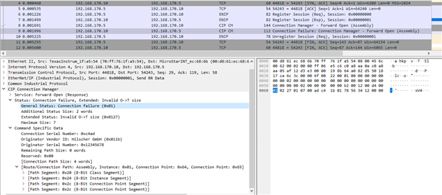

    Wireshark frames of implicit messaging with EnIPExplorer:
    LPEnIPImplicit.zip
    Also can you suggest me any open source EtherNet/IP Scanner like software where we can import and use EDS file if possible.
    D.Jenita

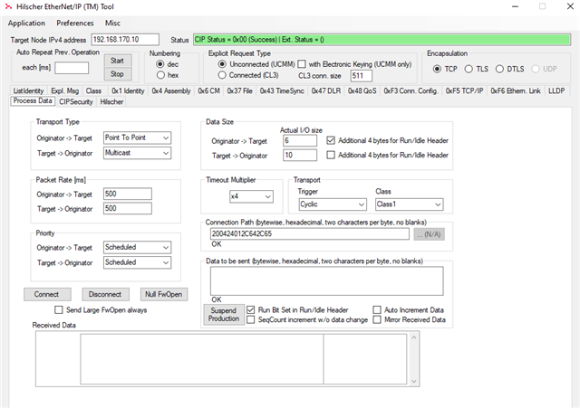

  • Hi Jenita,
    Configuring the Hilscher tool is relatively straightforward. Simply navigate to 'Preferences -> Local NIC', select the correct network interface, and enter your device's IP address under "Target Node IPv4 address". That's all the configuration you'll need.
    Regarding the Wireshark log, I was referring to the Explicit message tests that are failing on your end. The log you shared appears to show everything working as expected.

  • Hi Pourya,
    As I already mentioned I'm able to do Explicit messaging with Hilscher tool as in I configured Local NIC, Electronic Key and connected with Target Node.
    All I need is the configurations to do implicit messaging with Hilscher EtherNet/IP tool as in Configuring assembly objects, Connection establishment.
    How to configure 0x4 Assembly Object and
    Do I need to change configuration under Process data tab for implicit messaging
    I'm getting connection failure once the request sent from Hilscher Tool
    Is there anything else I need to do to achieve implicit messaging? Please guide me further
    Jenita

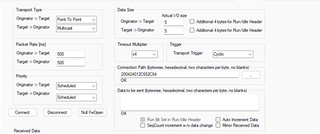

  • Hi Jenita,
    assuming you are using the original example without any modifications, I noticed two issues:
    1. The Connection path is incorrect and should be set to 200424012C652C64.
    2. The Data sizes are also incorrect. The device produces 5 bytes (T2O) and consumes 5 bytes (O2T), and it does not use a Run/Idle header.
    This information can be deduced from the EDS file delivered with the example.
    Pourya
  • Hi Pourya,
    Thank you so much.
    Implicit messaging working fine now after the configuration change.
