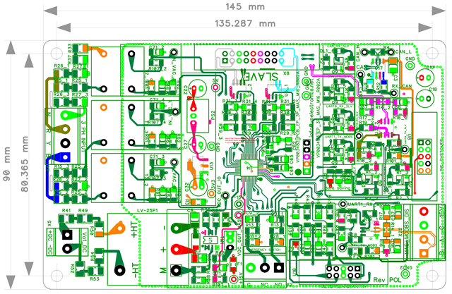

 high frequency crystal  issue   vary frequency not have stable frequency with cap C62 & 63 Please share layout if you recommendation of capacitor with crystal also sahre my laypout enclosed with
Enclosed with layout
    Have you select for suitable capacitor value?
    The capacity should calculated by C1 = C2 = (CL - CS) * 2, where CL is the load capacity of the crystal, and CS includes MCU pin stray capacitor (2pF) and PCB capacitor (2-3pF). You could select proper capacitor in your design.

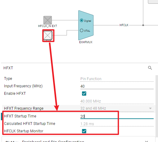

    And from the software side,  in sysconfig, when you configuring HFXT, you could use a littler larger HFXT startup time as below.
