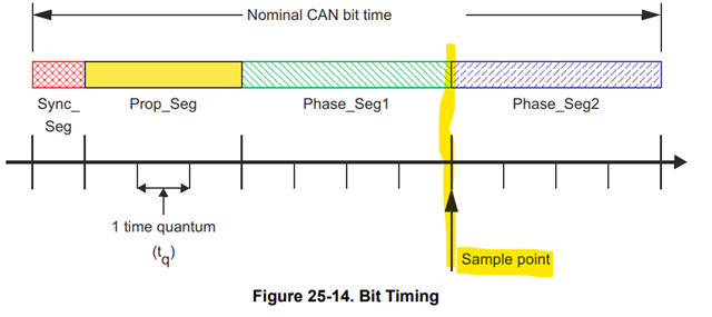

  • What is the CAN module clock frequency on the F28P65x?
    By default, the CAN bit clock is driven by device peripheral clock which is 200MHz. The clock divider defined in AUXCLKDIVSEL register is 0x13 at default. So the MCAN bit clock is 200/(0x13+1)=10MHz
    How do we configure the Nominal and Data bit timing parameters on the F28P65x side to achieve:
    The MCAN baudrate can be calculated using  BRP, TSEG1, TSEG2.
    Baudrate = MCAN bit clock / (BRP+1)*(TSEG1+TSEG2+3)
  • BTW, in CAN FD mode, it is crucial that the sample point configurations of two nodes match each other. If the sample points differ significantly between nodes, communication can become unreliable.
