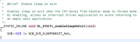

I'm trying to write firmware code for the MSPM0C1104 MCU.
Watchdog timer (WDT) function is a fundamental requirement on my code.
The MSPM0_sdk provides a "wwdt_window_mode_periodic_reset" example code.
I've slightly rewritten this example code, as shown in the attachment.
I've slightly rewritten this sample code, as shown in the attachment.
I've noticed that the main loop only executes before the first IRQ routine.
As the result, the program only executes the IRQ routine and never returns to the main loop.
Could any expert provide some advise?
Many thanks.

#include "ti_msp_dl_config.h"
int main(void)
    SYSCFG_DL_init();
    /* Enable TimerG interrupts on device */
    NVIC_EnableIRQ(TIMER_0_INST_INT_IRQN);
    /* Enable sleep on exit */
    DL_SYSCTL_enableSleepOnExit();
    /* Set LED to indicate Timer counter enable */
    DL_GPIO_clearPins(
        GPIO_LEDS_PORT, GPIO_LEDS_USER_LED_1_PIN | GPIO_LEDS_USER_TEST_PIN);
     * Configures timer to be halted if CPU is halted. This ensures
     * that timer is always aligned with the WWDT so it is never serviced
     * too late or too early.
    DL_Timer_setCoreHaltBehavior(TIMER_0_INST, DL_TIMER_CORE_HALT_IMMEDIATE);
    /* Start TimerG counter */
    DL_TimerG_startCounter(TIMER_0_INST);
    while (1) {
        //__WFI();
        DL_GPIO_setPins(GPIO_LEDS_PORT, GPIO_LEDS_USER_TEST_PIN);
        delay_cycles(1000);
        DL_GPIO_clearPins(GPIO_LEDS_PORT, GPIO_LEDS_USER_TEST_PIN);
        delay_cycles(1000);
        //DL_WWDT_restart(WWDT0_INST);
void TIMER_0_INST_IRQHandler(void)
    switch (DL_TimerG_getPendingInterrupt(TIMER_0_INST)) {
        case DL_TIMER_IIDX_ZERO:
            /* Restart WWDT timer */
            /* Toggle LED to indicate WWDT reset */
            DL_GPIO_togglePins(GPIO_LEDS_PORT, GPIO_LEDS_USER_LED_1_PIN);
            break;
        default:
            break;
