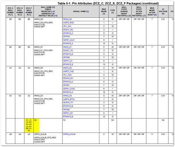

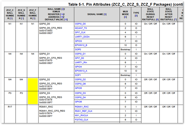

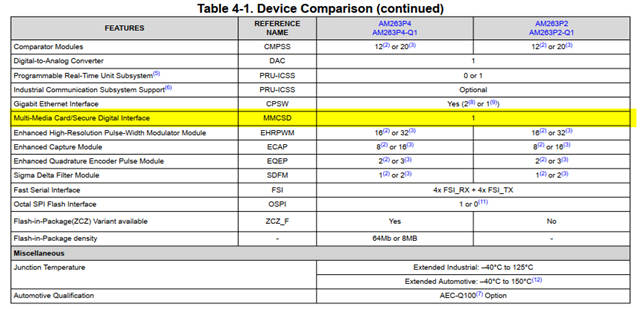

Team,
How do we connect additional external Flash to AM263P4 ZCZ_F package?
Since EMIF is not available on the AM263P4, and the only other way is to use OSPI for interfacing with external memory. AM263P4 has only one OSPI instance, and they have selected the ZCZ_F package for our design. I observed that in this ZCZ_F package, the only available OSPI is routed internally to the onboard 8MB flash.
Any other suggestions?
