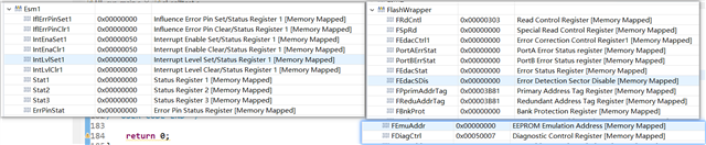

    My goal is to test the functionality of FLASH ECC. If a single-bit error or double-bit error occurs, I want to know where it happened and then record it (single-bit errors need to be counted).
    First, I need to simulate FLASH ECC errors. Based on your reply in another forum, I downloaded your FEE_ECC_Errors_TEST_LC4357.zip project.
    I have some questions about this project that I don't quite understand.
    -------------------------------------------- TEST DIAGMODE = 7------------------------------------------
    As shown in the figure below, I executed the code at the horizontal line in the figure.
    Since mode 7 is used, as expected, PortAErrStat should not be 0, the ESM Stat1 register should not be 0, Group1_Error should be set, and the ERROR light should not be on, but the result is the opposite, as shown in the figure below.
    Can you explain what this phenomenon is all about?
    Also, what are the concepts of PoartA and PoartB in the figure below?
    What problems will arise if the ECC error interrupt for Port B cannot be triggered?
    ---------------------------------------------TEST DIAGMODE = 5----------------------------------------------
    Perform the self-test shown in the figure below.
    The results are shown below.
    The selected register states are all as expected, but I noticed that regardless of whether the parameter passed is FLASH_ECC_TEST_MODE_1BIT or FLASH_ECC_TEST_MODE_2BIT, the Group2Error variable is set. Why is the Group1Error variable not set when the parameter passed is FLASH_ECC_TEST_MODE_1BIT?
    In mode 5 diagnostic mode, is the address tag error in Group3 always triggered?

  • I executed the code as shown below.
    The register values are as follows:
    The values are as follows:
    Is this right?Why doesn't a 1bit ecc error trigger an interrupt for group 1?

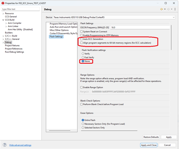

  • Hi Sam,
    I understood, why you are getting ESM2.3 error in your code. It is because of improper ECC values in flash,
    Refer below thread once:
    (+) TMS570LC4357: Uniflash tool could not erase the flash memory correctly. - Arm-based microcontrollers forum - Arm-based microcontrollers - TI E2E support forums
    So, this is the reason when we read any flash area it is triggering, Uncorrectable ESM flag that is ESM2.3.
    So, what i did is that i unchecked Auto ECC generation option in CCS.
    And i generated ECC using Linker CMD file for entire flash, including unused areas of the flash:
    After doing this modification, if i trigger 1-bit ECC error then i am only getting ESM1.4 not ESM2.3 anymore.
    I am attaching tested project at my end here, please go through it.

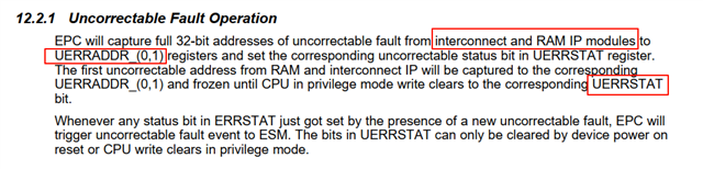

  • Hi, Gundavarapu
    1. The `SL_SelfTest_Flash(FLASH_ECC_TEST_MODE_2BIT, TRUE, &failInfoFlash, Port_Var)` function simulates a 2-bit error, but it remains stuck in a `while` loop and doesn't trigger an abort exception. What could be the reason for this?
    2. I looked at the manual again carefully.I discovered the following:
    2.1 What do "interconnect and RAM IP modules" mean? Does it imply that the content captured by the EPC does not include flash ECC 2-bit errors?
    2.2 Could you please explain what the following terms described in section 2-4 mean: CPU0 Correctable Error, CPU SCR Correctable ECC for PS_SCR_M I/F, CPU SCR Correctable ECC for DMA I/F, and L2RAMW RMW Correctable Error?
    3. What is the principle behind writing 0x45 to the FEMU_ECC register to simulate a 2-bit flash ECC error?

  • Hi Sam,
    Flash 2-bit ECC errors may not directly cause an abort exception always
    • On Hercules devices like the TMS570LC4357, a 2-bit Flash ECC error typically triggers an ESM (Error Signaling Module) event rather than directly causing a data abort exception
    • The error handling path is Flash ECC error → ESM → Potential NMI or error pin assertion
    It will definitely trigger ESM event and error pin assertion, but abort depends on many factors based exactly where error occurring.
    "Interconnect and RAM IP modules" refers to:
    • Interconnect: The internal bus interconnect that connects different modules (CPU, DMA, peripherals) within the SoC
    • RAM IP modules: The various RAM blocks in the device (SRAM etc.) that have their own ECC protection
    Yes, the EPC (Error Profiling Controller) does NOT capture Flash ECC 2-bit errors directly. The statement in the manual indicates that the EPC specifically captures uncorrectable faults from "interconnect and RAM IP modules".

    In your screenshots: Looking at your register dump, the ERR_STATUS_CLR register should be in the Flash wrapper register space. The registers you're seeing like:
    • EpcCntrl (0x0000050A) - EPC Control Register
    • CamAvailStat (0x0000001F) - CAM Index Available Status
    • CAM_Content0 (0x00020008) - This appears to be capturing an error address
    These are EPC (Error Profiling Controller) registers, not Flash wrapper registers. The ERR_STATUS_CLR is in a different register block specifically for Flash ECC control.
