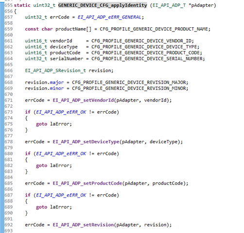

    Have you also updated your code to reflect the new Identity, including the Vendor ID, product code, and other relevant details?
    For reference, you can look at the Generic Device example, specifically the generic_device_cfg.c file, which contains the GENERIC_DEVICE_CFG_applyIdentity function. This function is used to configure the device's Identity.
    It's essential to ensure that the EDS file and the Identity object of your device are consistent, as any mismatch between the two can prevent a connection from being established.

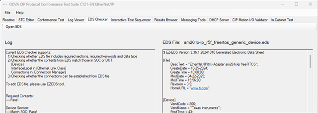

    Apart from that, you can use CT21 tool from ODVA to check your EDS file for potential errors on the file itself. (By using CT21 and creating a SOC file, you can also run conformance test to make sure your device is conforming to the standards)
    Here you can see a screenshot of EDS checker:
    Pourya
