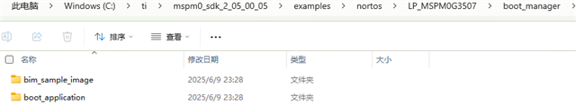

    What you said is seems a security boot requirement. You could take a hash verification of the image after the image has been loaded before you run the program. And also if there is any fail occurs, you could select to run from a older version program.
    You could check the below example for a boot management on M0G3507:
    And also if you want to know more about MSPM0 default bootloader protocol, you could refer the application note:MSPM0 Bootloader User's Guide

    Understood that you have your own SPI communication protocol and just want to migrate it to MCU to achieve a reliable bootloader function.
    Firstly, of course you could keep you current SPI configuration as your boot loader, actually bootloader is just another application program that achieves a communication to program a application image to a point address. We provide a ROM bootloader and some example for reference, but if you have your own protocol, you could achieve the whole communication protocol as you desired. It has the same purpose: make sure the image is well placed in target address after bootloader.
    And for your desired down-rev firmware function, I understood you do not need security function, but I think the hash is a good way to achieve your requirement. Image that, every time the MCU power on, it firstly check the hash of the new version image, if it is not matched (caused by some unexpected behavior during bootloader), the program will not jump to the new version image and directly go to the older version image instead. I do not need the signature verification function, just hash is enough for your requirement to check whether the image is "good".
