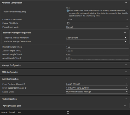

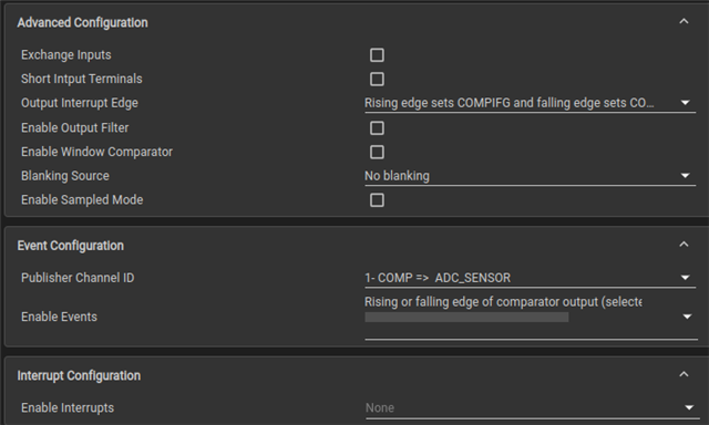

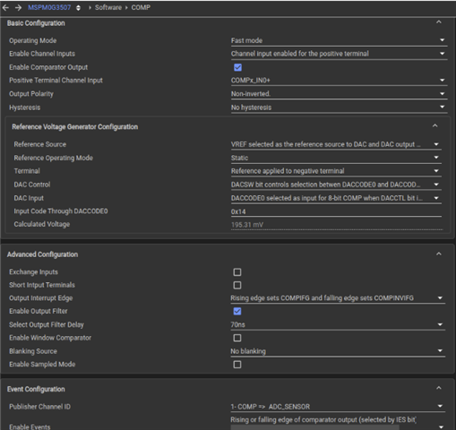

I'm working with the MSPM0L3507 and I've encountered an issue where the ADC reading varies depending on the DAC value set at the input of a comparator, even though the DAC value remains constant at each acquisition. This suggests some kind of interaction or interference between the DAC, comparator, and ADC subsystems.
Setup Details:
    The ADC is triggered by an event from the comparator.
    The DAC is configured to output a voltage that serves as one of the comparator inputs, defining a threshold.
    The reference voltage for both DAC and ADC is set to the internal reference: VREF+ = 2.5 V; VREF− = GND.
Could the comparator-triggered ADC conversion be affected by the DAC value used in the comparator? Are there any best practices for this kind of setup?
These are pics of my setup:
Any insights or suggestions would be greatly appreciated!

    Thank you for your reply. We did not performed a normal ADC acquisition because of the limitations of the ADC itself. Probably, it could be done with the window comparator ADC, but we did not tried it. However, we expect some fast pulses (500 ns duration) with specific heights that are not being registered properly. We should set up the ADC and the trigger to be fast enough and avoid delays. Please find below some excerpts from our code. Let us know if you see any areas for improvement.

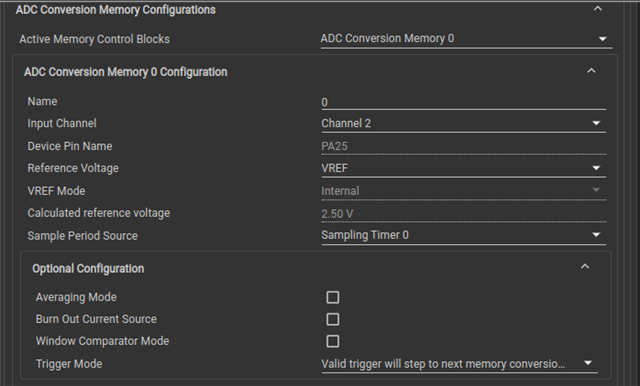

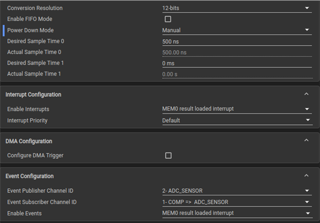

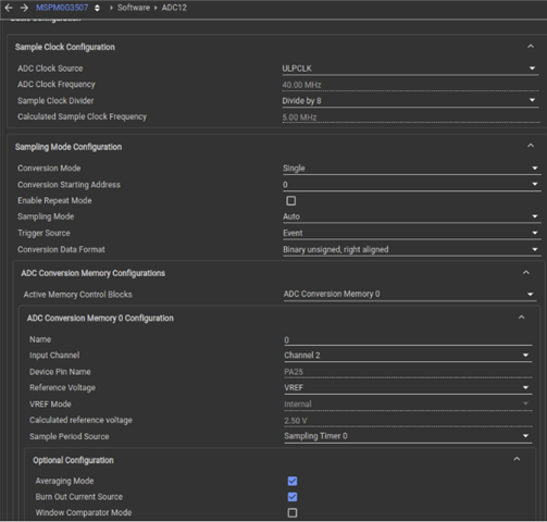

    This is the sysconfig for the ADC
    And this is the Comp:
    Specifically:
    1 - Could we use a higher clock for the ADC?
    2 - Is there another approach for faster pulse processing?
