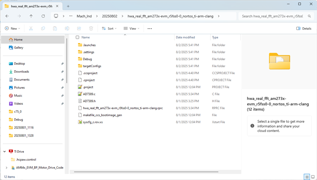

  • Hi Ming,
    When I try to share my example.syscfg file, I noticed that there is no that file in the Explorer as shown before. However, it indeed show in the project in CCS.
    Is that correct?
    I will zip my project and send to you in next message.
    Lin

  • HI Lin,
    In your zip file, I cannot find the example.syscfg file:
    Without the syscfg file, the syscfg cannot generate those files.
    Ming

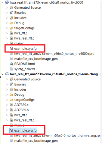

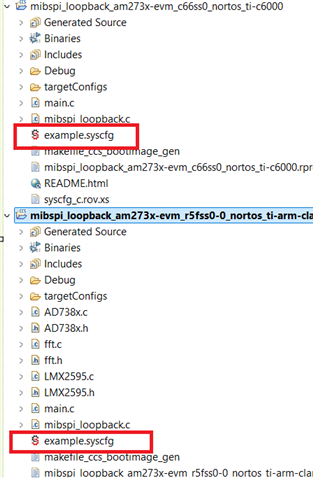

    More questions about the sample project hwa_real_fft's example.syscfg file. Please check the following screenshots.
    In the icons of the example.syscfg files of hwa_real_fft sample projects, there are blue arrow at the bottom right corners. But the other sample projects don't have that.
    Does that mean the example.syscfg file of hwa_real_fft has a alien or a link to somewhere else? So we can't find it in its own project folder. Or could you confirm that and explain it?
    That's why I gave the title of this thread.
    Lin

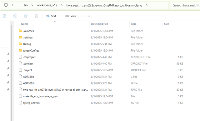

  • Hi Ming,
    More info for you.
    After deleting all the hwa_real_fft sample projects in my CCS and re-importing one in R5F core, I get the same results: no example.syscfg in the project folder and there are blue arrows in the icons of example.syscfg (and other .c files).
    Looking forward to your confirmation and solution.
    Lin
  • Hi Lin,
    The example.syscfg with blue arrow under it is the link pointing to the example.syscfg file in the original AM273x MCU+ SDK 09.02.00.60: C:\ti\mcu_plus_sdk_am273x_09_02_00_60\examples\drivers\hwa\hwa_real_fft\am273x-evm\c66ss0_nortos.
    The ones without the blue arrow are the copy of the original example.syscfg files to the workspace where your CCS projects were imported to.
    Ming

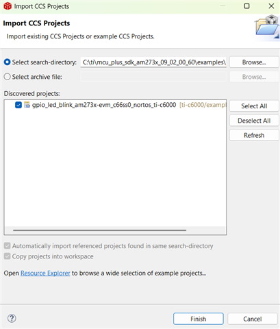

  • Hi Ming,
    Thanks for your pointing that out.
    However, from the importing procedure, the hwa_real_fft is same as the other sample projects as you can see from following screenshots.
    In both projects, the Copy projects into workspace box is checked by default. Then why after pressing the Finish button, will hwa_real_fft project LINK those files, but the other projects COPY the files?
    I still think hwa_real_fft has some specialty, but I don't know how it come.
    If you think that link or copy files setting doesn't affect the performance, then later I will share my modified example.syscfg file and modified hwa_real_fft.c file with you, as now we know where to find them.
    Lin
  • Hi Lin,
    In the example.projectspec file, each file has two options: either "link" or "copy". It is up to the creator of the *.projectspec files. The only difference between the "link" and "copy" is that whether the file will be linked or copied to the workspace. It will not affect the performance whatsoever. Just send me your modified example.syscfg file.
