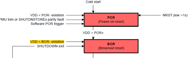

MSPM0C1103-Q1: Figure 7-1. Power Cycle POR/BOR Conditions
Part Number: MSPM0C1103-Q1
on the figure, a first transition from running to BOR status due to BOR assertion is shown (highlighted in green).
A second BOR assertion (highlighted in red) does not changes the status from running to BOR:
On Technical Reference Manual (Figure 2-7), the status diagram shows thet the condition "VDD < BOR- violation" always triggers a BOR.
What is the correct interpretation?
Thank you very much,
Jacopo
