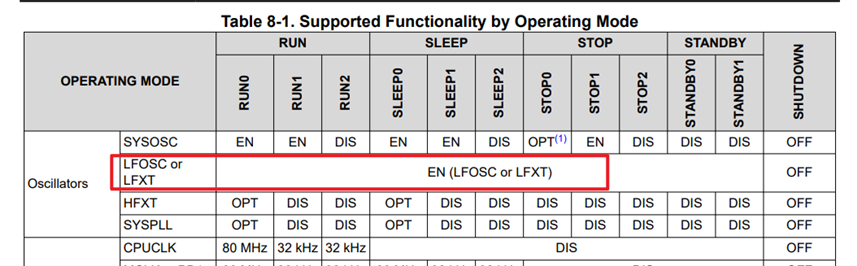

I'm working with a customer where we previously confirmed that the OPA can run in RRI mode with a 4MHz clock if the input is not changing (DC input). There was no slew rate check as part of the confirmation since the input is expected to be stable, not changing.
As a follow-up, the same customer is wondering if it is possible to use the OPA with only an LFCLK present, if again, the input is not changing (DC input). During times that they expect the input to change, they could enable SYSOSC.
Is it possible to use the OPAs with a DC input while the SYSOSC is disabled?
The clock requirements section for the OPA seems to suggest that the SYSOSC only needs to be active for chopping and rail-to-rail input. However, it does not explicitly state that if we turn off these features and the SYSOSC, the OPAs would still function.
Ideally, we would like the option to integrate your suggestion for working around the sleep2 issue("Before transitioning to sleep with the __WFI() call, switch the MCLK to LFCLK source. Then when you wake-up, switch the MCLK back to SYSOSC source.") with operational OPAs in cases where we wouldn't need RRI. Once again, the SYSOSC would be enabled in run when we are changing the OPA input, and when we go to sleep and the input is stable, the SYSOSC would be disabled.
If we need RRI, we would run the SYSOSC at 4MHz during sleep.
My initial thought was that VBOOST might be a limitation. However, upon reading the appropriate TRM section, it looks to me like VBOOST can operate off of the LFCLK.

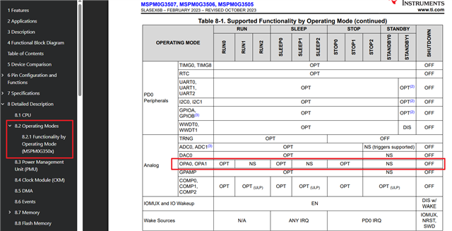

    Besides focusing on the clock, please also check if the OPA supports different power consumption modes. According to the datasheet mspm0g3507 datasheet, the table as shown below list the description of whether the corresponding peripherals under different low power mode can be used. But It worth noting that the OPA is NS(Not supported) under the Sleep2 mode.

  • Peter,
    Yes, both myself and the customer are aware, and reviewed this table ahead asking the question here in this thread. I checked in with the customer, and they have already tested it on their end. If they transition to Sleep2 (LFCLK active, SYSOSC disabled), the OPA appears to remain enabled and hold its output value.
    ...so the behavior the customer is asking for appears to work. They are wanting to know what might be the unintended (undocumented) consequences of this, as they would very much like to operate in this mode.
