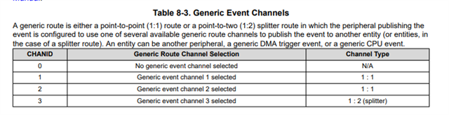

    There are only three channels, you can refer to the datasheet.

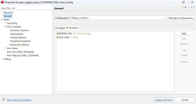

    And I have checked the Sysconfig 1.24, it just shows three channels.

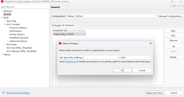

    So you can try to download the latest SDK from ti.com. And then right click your project: "properties" -> General -> Products -> edit, Edit the SDK and Sysconfig to the latest version. And then check whether the issue still occurs.
