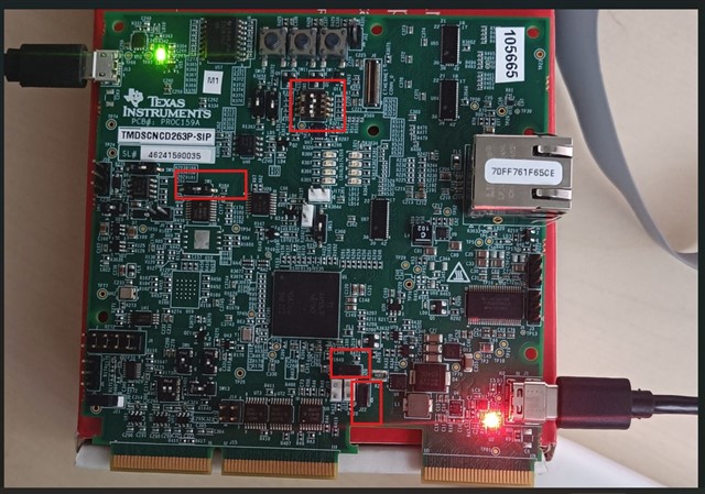

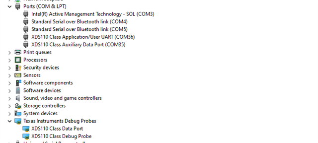

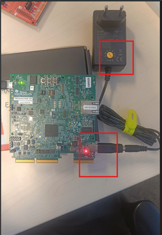

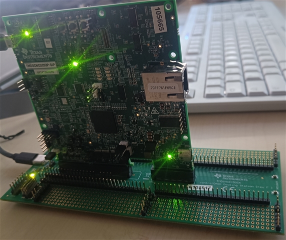

Hello Team,
we are currently working on  AM263Px SIP board.
we were working on LIN Communication connection. we tried to execute the LIN example. But after Mcu reset we are not able to send data through the UART XDS110 debug probe and also always we are getting the same error
This error is generated by TI's USCIF driver or utilities.
The value is '-233' (0xffffff17).
The title is 'SC_ERR_PATH_BROKEN'.
The explanation is:
The JTAG IR and DR scan-paths cannot circulate bits, they may be broken.
An attempt to scan the JTAG scan-path has failed.
The target's JTAG scan-path appears to be broken
with a stuck-at-ones or stuck-at-zero fault.
Can you please let us know how to resolve this error.
we even tried to update XDS110 firmware, but even then same error.

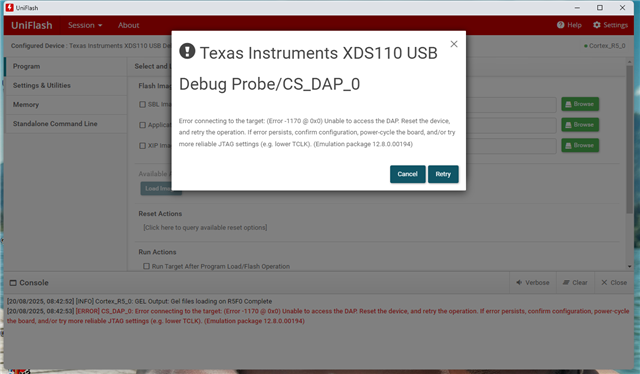

we tried to connect through uniflash tool but also same error.
we have adapted the required switch setting that is SW1 to XDS110 position.
This was working earlier for us, but when we tried LIN connections , from that time, we are facing this issue
