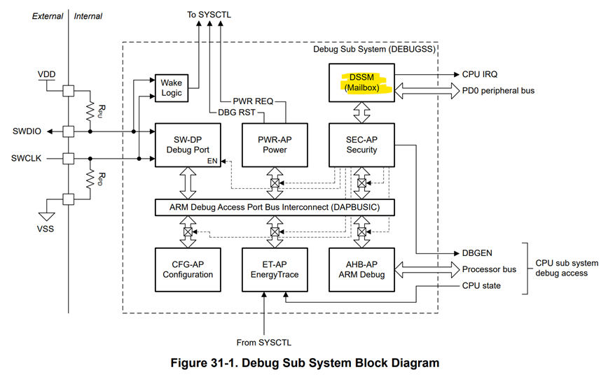

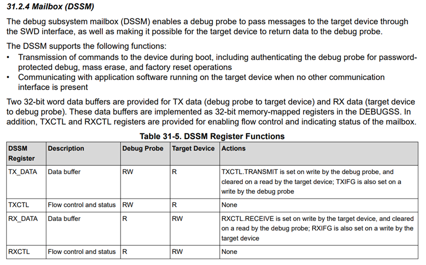

Hello guru,
I'd like to know the process of DSSM factory reset.
As I know the process
1. Write factory reset in the DSSM
...... ??? (I wanna know)
99. Factory reset is conducted
How does it work without enabling CPU?
Thank you in advance
