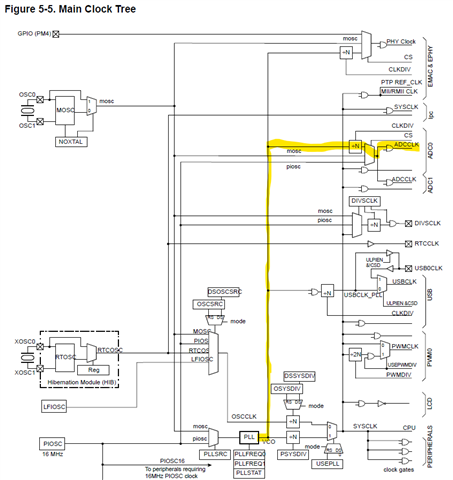

      1. First of all, when you specify PLL as the clock source for ADC, it is NOT the ui32SysClock that is fed to the ADC to produce the ADDCLK after the divider. It is rather the PLL VCO that is fed to the ADC to produce the ADCCLK after a divider. The PLL VCO output depends on how you configure the System Clock. If you use the TivaWare to configure the System Clock for 120Mhz then the PLL VCO will be 240Mhz. In another word it is a fixed 240Mhz that is fed to the ADC no matter what the System Clock is. Even if you make the System Clock equal to 16Mhz, the VCO output is still 240Mhz going to the ADC. Refer to the datasheet and the Clock Tree Diagram.
    ■ Divided PLL VCO. The PLL VCO frequency can be configured to generate up to a 32-MHz clock
    for a conversion rate of 2 Msps. The CS field in the ADCCC register must be programmed to
    0x0 to select the PLL VCO and the CLKDIV field is used to set the appropriate clock divisor for
    the desired frequency.

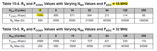

      3. The ADCClockConfigSet API does NOT alter the sample and hold time. Your statement ADCClockConfigSet(ADC0_BASE, ADC_CLOCK_SRC_PLL | ADCrate,  ADCdivisor) is used to configure the ADC source clock. As I mentioned the ADC_CLOCK_SRC_PLL is equal to 240MHz no matter what ui32SysClock is returned with. The ADCrate is used to control how often samples are provided back to the application. The ADCdivisor divides the PLL VCO to define the ADCCLK frequency and both of which have nothing to do with the sample and hold time.
      4. The Sample and Hold time are automatically programmed when ADCSequenceStepConfigure is called. You can look at the source code of ADCSequenceStepConfigure  API.  There isn't really a need to manually change the sample/hold by user.
      5. I think your issue has more to do with the misunderstanding of the PLL VCO (240Mhz) than the sample and hold. As you can see from the below table, to achieve a 1Msps, you would need 4  ADCCLK cycles running at 16Mhz for sample/hold.  If you were to call something like ADCClockConfigSet(ADC0_BASE, ADC_CLOCK_SRC_PLL | ADCrate, 1), you are actually programming the ADCCLK for 240Mhz as in 240 divide by 1. This is of course incorrect.  ADC can't run with a 240Mhz clock. To achieve 16Mhz of ADCCLK using PLL VCO you would need to call something like ADCClockConfigSet(ADC0_BASE, ADC_CLOCK_SRC_PLL | ADCrate, 15).
  • Thanks for the response. This has led me to the correct answer.  I investigated further on the PLL VCO as you suggested and found the TM4C129
    SysCtlClockFreqSet function is passed a parameter to set the PLL VCO frequency.  This has options of
    SYSCTL_CFG_VCO_320 or SYSCTL_CFG_VCO_480 which set a frequency of 320MHz or 480MHz.
    My setting of the sample and hold period in the individual sample steps was having no impact because 4 clocks was sufficient, and hence making it longer had no improvement on the voltage measured.
