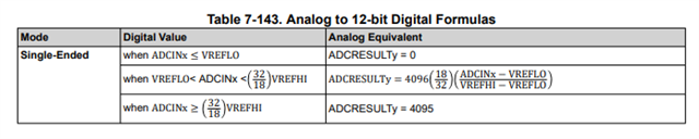

I am reading ADC digital values from ADC_RESULTS_ADCRESULT0 register with "ADC_readResult" function. How should I calculate analog voltage from digital value?
I found this equation in reference  manual but this is not giving me correct analog value.
Thank you for help.

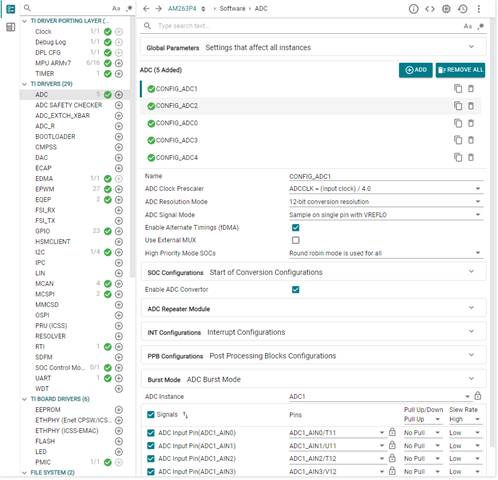

    Can you please share your full setting on the ADC module and which ADC you are using. Also, please share a schematic on how your external test signal is connected to the device. Thanks.
    Han

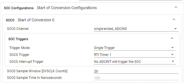

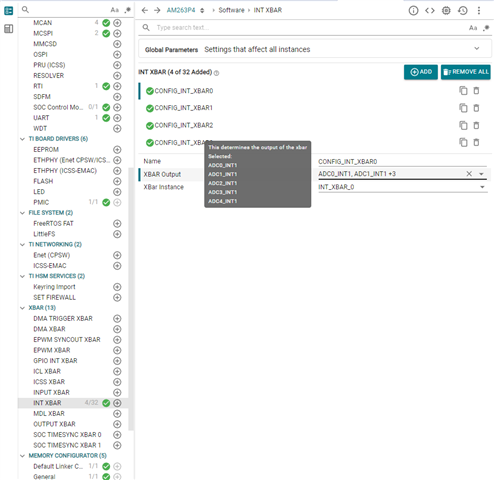

  • Hi Han,
    I can not share my syscg file because this website is blocking that. Therefore, you can find my configuration inside of the pictures. I will all of the pins inside of configuration. Values that I shared belong to ADC4-AIN1 and ADC1-AIN2.
    SOC configuration is same for AIN. I am trigering all channels with RTI.
    Other configurations are same as SDK example.

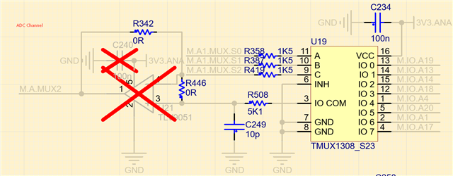

    Scheamtic:
  • Hi Basri,
    Does the M.A.MUX2 signal doing directly to MCU ball? The C249 is only 10 pF and is too small for input bucket capacitor.
    Han
  • Hi Han,
    After output of mux, there is just C249. “M.A.Mux2” is connected to MCU-ADC pin.
    I realized after sharing the schematic with you that TL9051 did not use.
    Is the bucket capacitor problem in my case? Do you have any recomendation? I can try on my board.

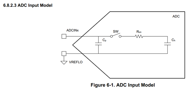

  • Hi Basri,
    Refer to the input model for ADC, sample capacitor Ch is 8 pF. Recommendation for input bucket capacitor is > 20x larger than Ch and low impedance input. Since you have a 5.1 kOhm filter resistor, it is better to have a larger input capacitor.
    Please try to use a larger input cap. If you don't want to make HW change initially, you can try to change sample window to a much larger value, and see if the result is better (closer to expected value).

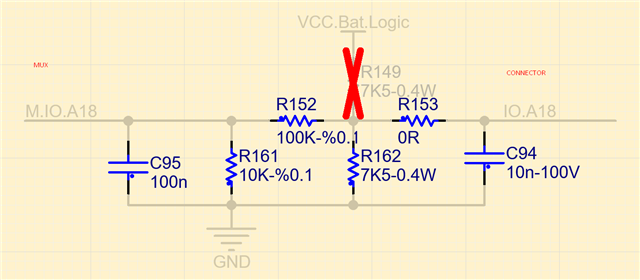

    I made a few test on my board and I figure out that resistor values on board are not same as in variant file(100K-9.53K). Therefore, I was making the calculation with wrong values.
    On the other hand, I tried different combination for ADC input but I did not see any difference for 12V input. I have to test with different voltage ranges. If I test something like that, I will share my results under this section.
    I tried the combinations below:
    5K1 - 10pF
    0R - 10pF
    5K1 - 330pF
    I am not sure about using a larger cap because I am using  a switch(Mux) before ADC inputs. How should I test this case?
