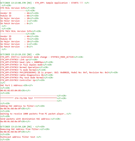

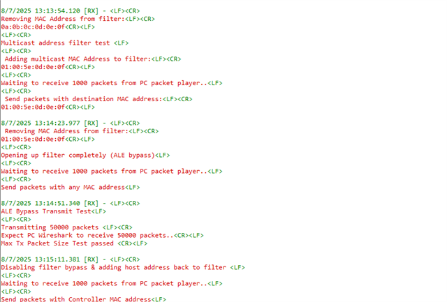

    I tired to load and run the SIP example of Eth_APP in AM263P MCAL SDK in PROC159E2 board. I was able to run the example as well.
    Please see the below logs,
    In this example, I sent 1000 packets from my PC to the controller using ColaSoft and was able to receive 5000 packets in PC which is being sent by the controller. Observed the same on wireshark.
    The Eth_app requires the PC to send 1000 packets to specified MAC address. In the logs it is shown that the controller is waiting for the PC to send 1000 packets. Can you trying sending packets from your PC to the controller?

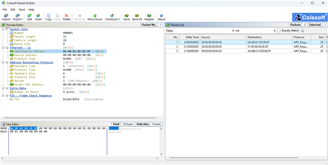

    To run the example, we need a packet sending tool and a network analyser like wireshark
    I used Cola Soft packet sender to send the packets from PC to controller. In this example, initially the PC needs to send packets.
    The packets needs to be sent with a particular MAC address that is mentioned in the logs.
    While sending packets, make sure that packet is send via the correct Ethernet Adapter.
    This is my packet sending application. I have configured the destination MAC address as mentioned in the logs. Configuring any other would cause the ALE to drop it.

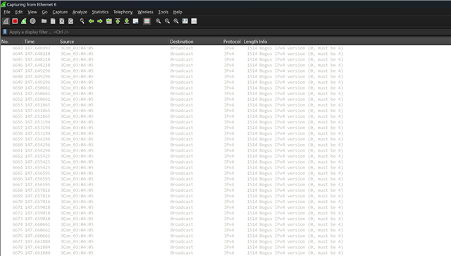

    After sending some packets from the PC to controller, it will send 5000 packets back.This can be confirmed via the wireshark. The below attached image shows that.

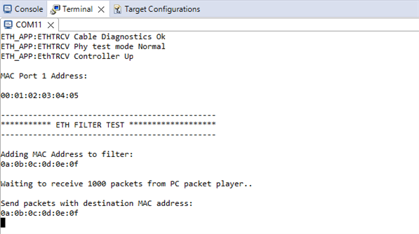

    I have followed all the steps given in Userguide 4.13.10. and build the application of eth_app and tried on SIP Board still i am not able to see any broadcast message from Wireshark
    and in CCS the terminal window is showing like this. The data is not updating
    can you please check this and provide me your feedback
