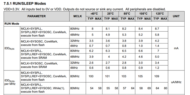

MSPM0G1507: Current Consumption in RUN Mode and MCLK=16MHz
Part Number: MSPM0G1507
Hi Team,
Our customer would like to know about the current consumption when XMSPM0G1507SYCJR in RUN Mode and MCLK=16MHz.
I found the current consumptions in Datasheet, could I use IDD_RUN per MHz to estimate the current consumption when MCLK=16MHz?
For example: When it is CoreMark, the current consumption is close to 100*16 uA
If there is wrong, please let me know!
B.R.
Eason Chou
  • Hi Eason,
    Yes, if your clock configuration is the same as described in the box. And if you check the two rows of data as shown below, you can find that it is calculated based on the per MHz.
    Peter
