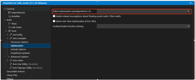

    1. My program does not have an optimization level enabled, as shown in the picture

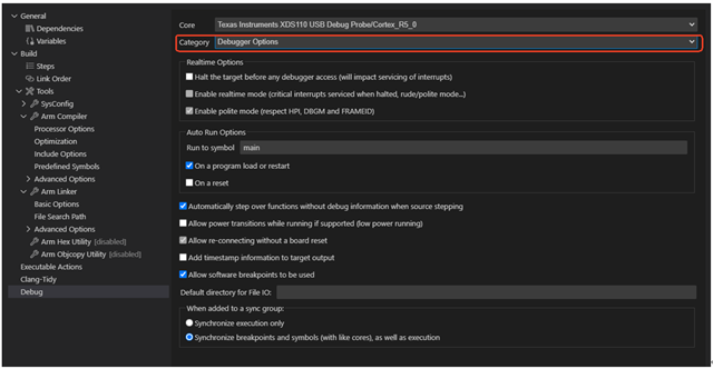

    May I ask if the settings in the following image are reasonable, and if it is due to changes in the settings below that the interruption point cannot be interrupted
  • 1. My program does not have an optimization level enabled, as shown in the picture

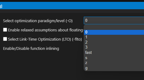

    Please note that "empty" does not mean "off". It means to use the default. In many cases the default has some level of optimization.
    To turn it off, please explicitly set it to "0":

    Your debug settings are likely not the issue here. Please try disabling all optimizations.
