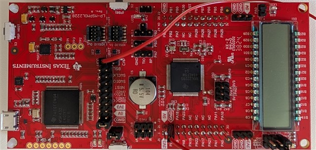

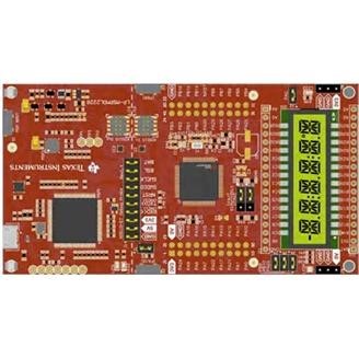

is there a plan to update the Launchpad User's Guide. Current one shows this one
and customer has this one
He wants to use the supercap and it not described.
Regards, Holger

Hi Holger,
Thanks for pointing this to us,
Yes, we missed to update the LaunchPad UG when we do some update on its hardware, I will forward this thread to the owner of the L2228 LP UG and take a fix on next release.
You can see the below gives the option to use VDD or Super Cap to VBAT:
If they connect all three pins together, then the VABT is enabled with a super cap and on-board 3V3. Or user can connect VBAT and CAP only, then there requires an external power supply to VBAT [Or eanble internal path of VDD (MCU) to power the VBAT external capacitor].
B.R.
Sal
