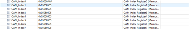

Using Auto ECC generation from CCS while programming in both Debug and Release builds. default .cmd linker file from halcogen.
In Debug session on a debug build, i can see all the CAM entries are available. Error Pin Key status is 0x1H indicating no errors.
Debug ECC Errors
In Debug session on a release build, i can see 2 CAM entries are occupied, Error Pin Key status is 0x0H indicating errors on ECC validation.
CAM entries.

  • Hi Jagadish,
    I had some success in getting accurate ECC values to be populated at designated Flash ECC space 0xF0400000 by modifying .cmd file and Enabling --ecc=on option in linker (CCS) (This second step is missing from all the guides that talk about Linker generated ECC, This should be updated where necessary by TI team).
     i get the idea behind storing 64bit aligned address of the flash that generated the fault, regarding the data is masked with byten,still do not understand what it means. any luck ?
