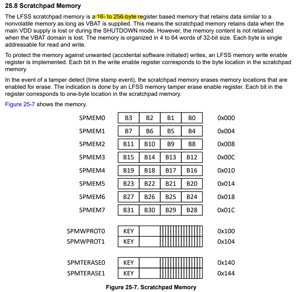

Hello guru,
I'd like to know Scratch memory size in MSPM0L2228 or other MCU which has LFSS system.
The L series TRM says '16B to 256B' but there is no specific information in MSPM0L2228 datasheet.
Could you share exact size of MSPM0L2228 and update the datasheet?
