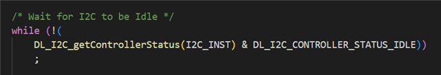

Another thing, the example program uses this while loop to ensure the I2C peripheral is not busy before moving onto the next step. In what situations can the software get stuck here and what are the solutions to this.
    Please check the I2C bus status, sometimes the I2C bus is stuck (SCL forced low by slave) will make the I2C keep in BUSY status.
    In this situation, would a should there be a timeout within the while loop?

    Interrupt is a convenient way as it can break the while loop easily and do not need poll the status to check. Use polling method to check its bus stauts also works.
    As recommended by Bruce, the ERROR bit can be used to check the NACK condition (slave address NACK or TX data NACK). the BUSY bit can be used to check bus status.

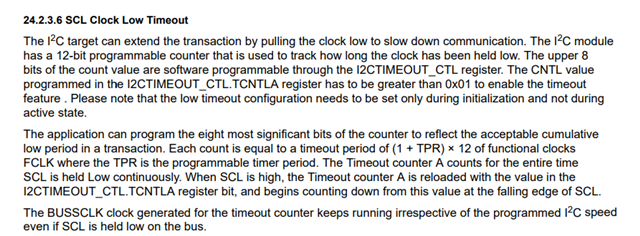

    You can use below function to detect if there has an SCL timeout:
    Or, use a generic timer and read the SCL/SDA time if it keep LOW for a certain time, trigger a timeout. We support read SDA/SCL status by I2C register.
