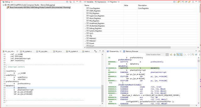

I have created a FreeRTOS privileged task and in the task , all it does is sleeps for 1 second and after 10 seconds it resets. When I run from the Code Composer in debug mode, I see it works for the first Reset but the next Reset, it gets stuck in sciInit function.
What I found was that, after first Reset, the reset source is set to DEBUG_RESET, so it is going through _memInit_(), _coreEnableEventBusExport_(), systemInit(), _coreEnableIrqVicOffset_() ... etc. The next Reset source is set to NO_RESET, so it is not going through the normal initialization process, which is probably the cause. Could you please let me know what is the best way to reset the system, do I need to follow any specific procedure for reset. Note that, if I do reset the board with Power On Reset switch, it only runs once, the reset gets stuck in the sciInit like
