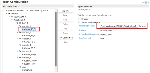

So I suggest them use devboot and download this project to core1 directly.
The process is show in below: load the ccxml, connect the core0 but don't program the code to core0 and then connect the core1 and download the project to core1. and then reset the core1 and run

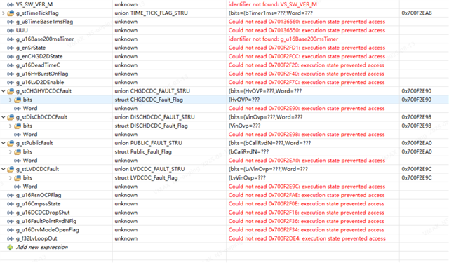

3. Why it can't watch the variable refresh?

    For the variable refresh, it looks like the core is halted, preventing you from reading the variables.

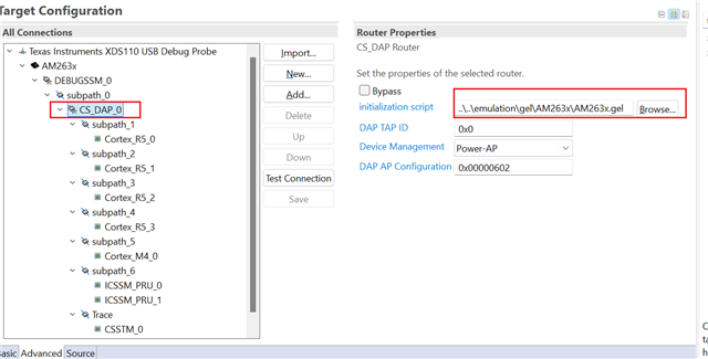

    It is because of the ccxml file: in default ccxml, it will init chip when it connects to core0,
    if you want to init chip when it connects to core1, you need to add gel file to CS_DAP, then you can connect to core1 directly.
