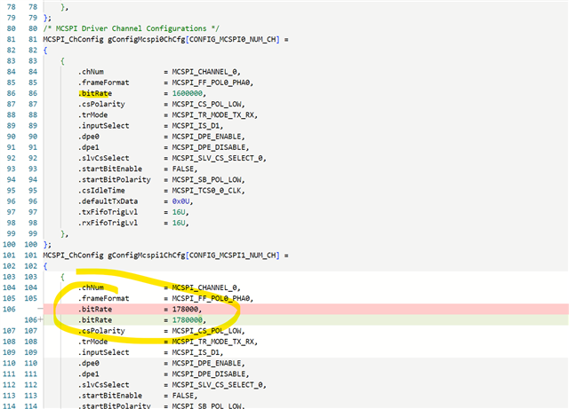

I want to configure the SPI Clock for the AM623. But for some SPI frequencies I get 2 parameters in the ti_driver_open_close.c
What do I wrong?
Does sysconfig detect wrong SPI clock settings?

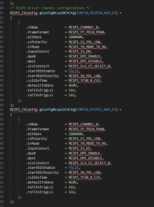

    The results which I am about to show are based on the latest SDK and SysConfig.
    Upon adding two MCSPI instances, I do not see the frequency difference as you are seeing.

    To summarize you have configured two MCSPI Instances in SysConfig, lets suppose SPI1 and SPI2 Controllers, and each of these have different frequencies configured by you, hence you see those exact values reflected in the generated files. Hope this helps clarify your doubt.

    Just to clarify, the two frequencies which you see, one which is 1600000 and 1780000 are of two different MCSPI instances added by you. And these numbers are configured by you.
    For example, have a look at the following screenshot:
    I have declared:
    1. CONFIG_MCSPI0: For this instance I set frequency as 123456(just to demonstrate, I have written this random number), this number is reflected on the generated file.
    2. CONFIG_MCSPI1: For this instance I set frequency as 178000 and hence you also see this on the generated file.
    In your application you can use lets say MCSPI1, then that would mean you are operating in 178000 frequency and if you use the MCSPI0 in your application that would mean you are operating at 123456 frequency.
    Hope this clarifies your doubt.
