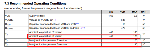

    No, we don't. Our device can not work over than 125 Ta (130Tj).

         If the temperature above 125 ℃ exceeds the standard range, let's not talk about it. However, below 125 ℃, the difference in ADC sampling values
         for the same source is far beyond our understanding.
