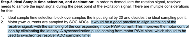

As stated in the title I want to synchronize the resolver signal sampling with the motor PWM current sampling as proposed in the technical reference manual 7.5.3.1.6 - Step 5.2:
Is there any guideline how to do as proposed in the last sentence marked: "A synchronization pulse coming from motor PWM block which should to be used to synchronize resolver ADC sampling time." ?

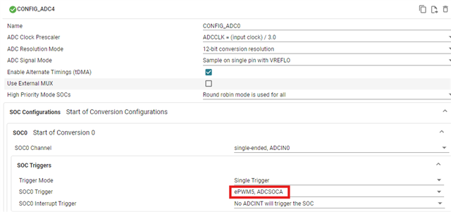

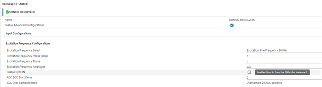

    While I can find the setting for the normal ADC in the syscfg gui:
    I can't find anything similar in the Resolver parts.
    Can you show me where to put this information?
    Best regards
    Norbert
  • You can check the example on "C:\ti\motor_control_sdk_am263x_<version>\examples\tidm_02018_universal_motorcontrol" as reference and let me know if this resolves the issue. The marked location in your screen shot is the right place to set ADC SoC trigger.

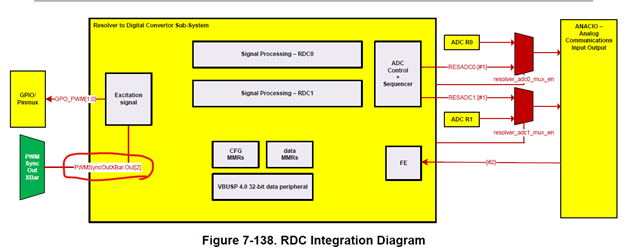

  • I think the main question of Norbert is, how to enable the synchronisation of the resolver module.
    The example you mentioned Masoud is for am263x, which doesn't have the resolver module.
    if iam correct, you can enable the sync in the excitation freq menue of the resolver. The input for the sync is PWMxbar2
    there the PWMx_TRIPOUT can be choosen. But where can i configure this?
    Marcel
  • Hello Norbert / Marcel,
    TIDM-02018 is the software based on AM26x that demonstrates how the ADC syncs with PWM. Once it's out, the AM263Px based traction inverter will serve as the perfect reference for showcasing the ADC-PWM-Resolver sync.
    Regarding PWM-Resolver sync, the resolver’s SYNC_IN should come from the PWM XBAR, and the cleanest source is an ePWM SYNCOUT or a well-timed SOCA pulse if you prefer. In SysConfig you can wire this up end-to-end, first enable “Sync In” at “Resolver -> Excitation Frequency Configuration” and select PWMXBAR2 as the sync source (matches the TRM note).
    Then map PWMXBAR Output 2 to EPWMx SYNCOUT (e.g., EPWM0 SYNCOUT).
    Now, configure your ePWM to assert SYNCOUT at the sampling instant you want (e.g., CTR=ZERO or CTR=PRD, depending on where you sample currents).
    If you prefer using SOCA for ADC current sampling, you can still keep SYNCOUT aligned to that instant so resolver sampling lands at the same phase of the PWM.
    Masoud

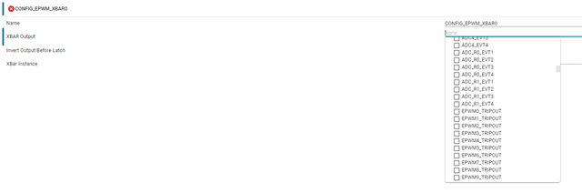

  • Hey Masoud,
    thats what we are looking for, we try that out. Maybe you change the note in systemconfig:
    because we tried using EPWM XBAR (like the hints says) instead of EPWM SYNCOUT XBAR.
