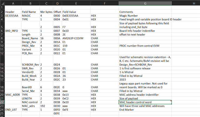

I just got an LP-AM261 board. The MCU+SDK “Hello World” example ran fine, and the “ICSS-EMAC LwIP Example” also worked. However, other networking samples, specifically the “Enet LwIP UDP Client Example” and “Enet LwIP TCP Client Example” did not work. I tested with and without DHCP, directly between the LP-AM261 and my laptop and also through a switch, and I tried multiple Ethernet cables.
