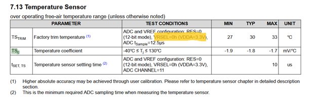

I was measuring the temperature using Internal temp sense from ADC.
The read value from TEMP_SENSED data is 794, while the ADCcode at 30C with 12bit and 3.3vref is 792.
If i use 1.4V for Vtrim calculation and 3.3v for vsample calculation i get -174.171C
but if i use 3.3V for both calculation i get 29C which is very accurate and is proper for all values.
Is the factory measurements done at 3.3V or 1.4V? Is it mentioned anywhere?
