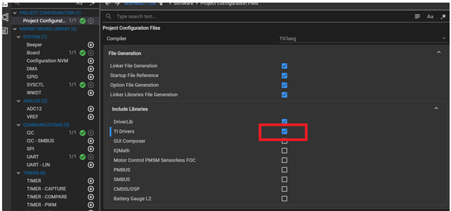

Can the MSPM0C use the TI drivers?

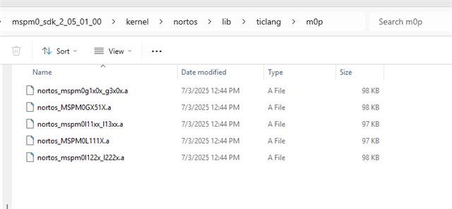

When I select TI drivers in syscfg, I will get errors from building project.
Also I didn't find mspm0c110x.a in SDK.

Upon checking again, I don't seem to see a drivers_mspm0c110x.a in my SDK as well. I think the option to include the TI Drivers in SysConfig for MSPM0C110x devices needs to be removed. Sorry for the confusion.
