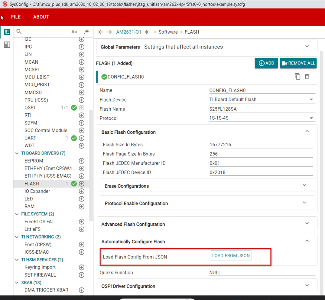

    From what I am understanding you are using a custom QSPI flash instead of then default flash present in EVM, in this case you will need to update SysConfig with the custom flash json file in both the sbl_qspi and jtag_uniflash
    1. C:\ti\mcu_plus_sdk_am263x_10_02_00_13\examples\drivers\boot\sbl_qspi
    2. C:\ti\mcu_plus_sdk_am263x_10_02_00_13\tools\flasher\jtag_uniflash
    Please follow the below steps to update the example.syconfig
    1. Import both the projects to your workspace
    2. Open the example.sysconfig file
      1. Navigate to FLASH tab and  update the Flash Name
      2. Click on the Load from JSON  button and select the <custom_flash>.json file from the <path_where_json_is_present>
      3. Predefined flash JSON path in mcu_plus_sdk : C:\ti\mcu_plus_sdk_am263x_10_02_00_13\source\sysconfig\board\.meta\flash
      4. Save and build the example projects
    3. Now once the examples are built, use the custom flash option in uniflash9.2 to load the custom flasher binary.(use the appropriate path and .out file similar to the image below)
      1. Do Erase entire flash, just to ensure a clean start and paths are correct (optional)
      2. Keep the bootmode to Devboot (so that the image that was flashed previously might not be executing while we are trying to reflash)
    4. Load the newly built sbl_qspi and hello_world images after a power cycle.
    Please try the above steps and let us know your observations.

  • Hi Michael,
    I have already modified the both the JTAG Uniflash loader syscfg
    Just to confirm, have you modified "C:\ti\mcu_plus_sdk_am263x_10_02_00_13\tools\flasher\jtag_uniflash" ----> present in tools folder ? This flasher_jtag.out should be used in the Uniflash tool custom flasher field.
    Reconfirming this as I saw mentions about sbl_jtag_uniflash project which is present in  C:\ti\mcu_plus_sdk_am263x_10_02_00_13\examples\drivers\boot\sbl_jtag_uniflash.
    NOTE: .out generated from ..\tools\flasher\jtag_uniflash is used by UNIFLASH tool, not "..\examples\drivers\boot\sbl_jtag_uniflash."
    Thanks & Regards,
    Rijohn
  • Hi Rijohn,
    That was it!  I had only seen the "sbl_jtag_uniflash" section of the documentation under "Tools and Utilities -> Flashing Tools -> JTAG Uniflash" and not the one present under "Uniflash Custom Flash Writer" which is what you pointed to.  When I use the latter, and apply the flash device customizations, I am able to flash the board via the Uniflash GUI Sunglasses
