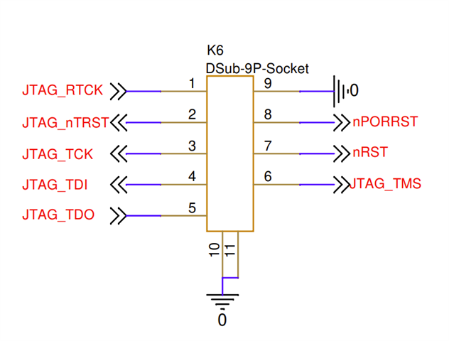

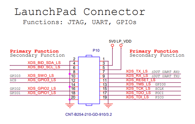

  • Hello Jagadish,
    Thanks for the clarification. I am still not clear with the nTRST pin on the XDS-110 launchpad. I understand that nTRST has to be pulled down when not in use, and driven to logic High when JTAG is to be used. Below is the photo from XDS-110's schematic. Do let me know which pin do I need to interface with nTRST of the controller.
