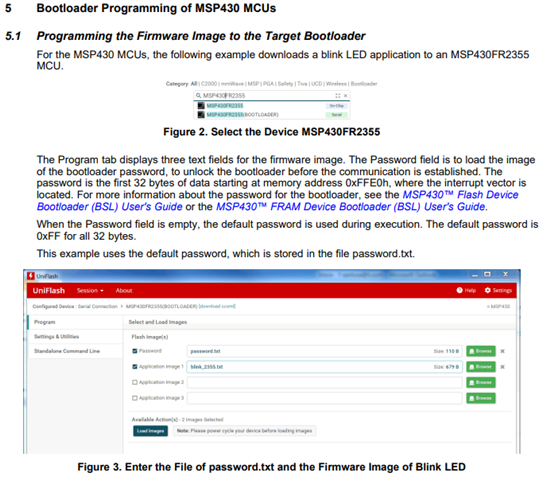

  • Hi Alan,
    In Uniflash, reference section 5 in Program Bootloader of MSP430, MSP432, CC13xx, CC26xx, CC32xx MCUs Using UniFlash:

    Thank you for your support and information.
    I am able to do the BSL upgrade with password enabled by using UniFlash.

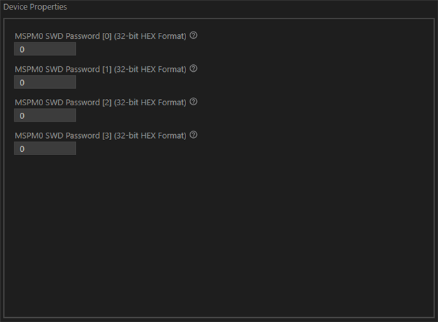

    To debug the device using a password:
    1. Navigate to the .ccxml file and open it
    2. In the bottom left of the window that opens, click on Advanced
    3. Click on the device, in this case: MSPM0L1106
    4. On the right you should see this:
    5. Fill in the password
    6. Save the file
    7. You should be able to debug the device now, but if not try the steps below
    8. Right-click on the .ccxml file and click on Start Project-less Debug

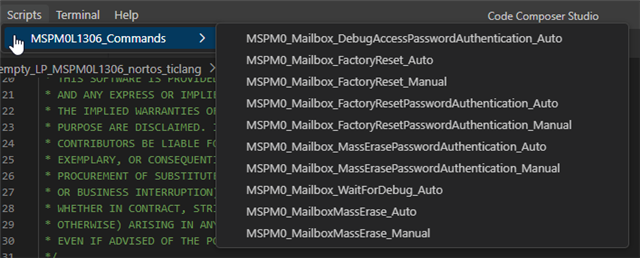

    9. In the top menu bar, click on Scripts
    10. Expand MSPM0L1106_Commands
    11. Click on MSPM0_Mailbox_DebugAccessPasswordAuthentication_Auto
    These steps will only work if you had correctly configured the security settings to allow for debug access via password.

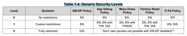

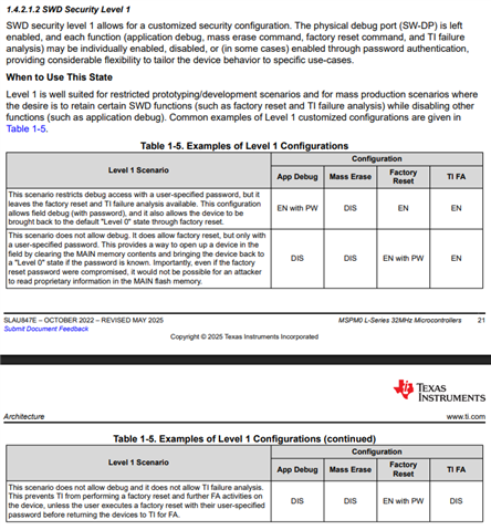

    According to the info provided about SWD security level 1, it is just an example. According to the Table 1-4. Generic Security Levels :
    From the table both mass erase and factory reset can be enable with password. So I think it should be somewhere to enter the password to do the action accordingly.

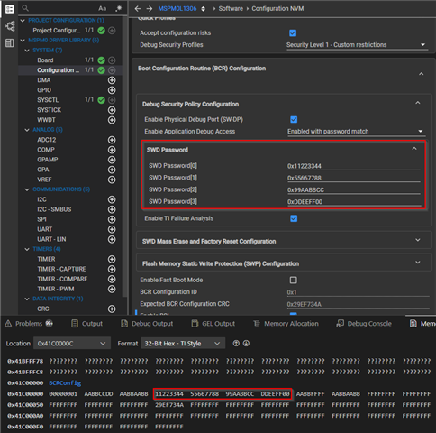

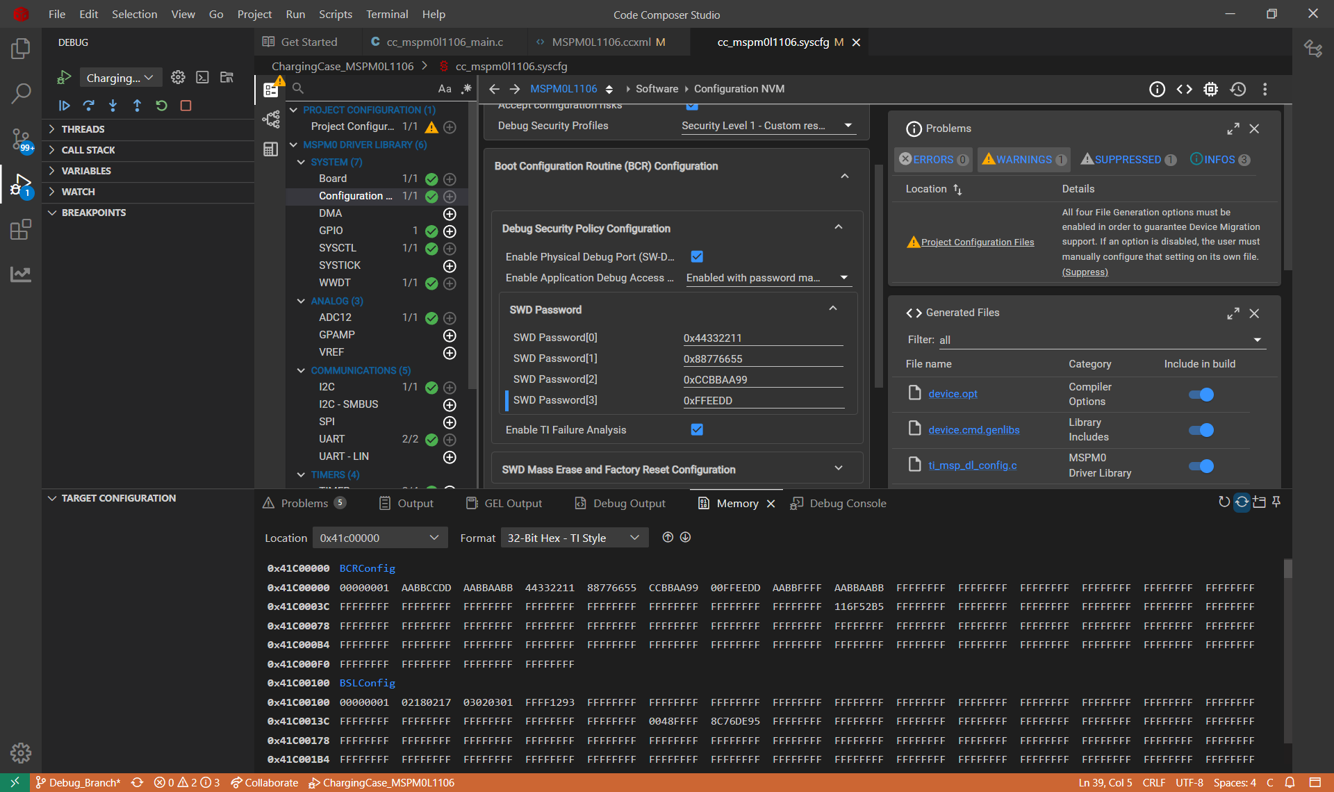

    The following is the first few bytes of by BCR config data in my device :
    In CCS, I tried both the order of the password as below, and they are not work. Could you provide me more advice on it?

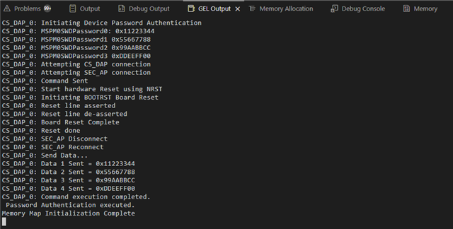

  • Hi Alan,
    Sorry for the oversight, I had referenced the incorrect table. How did you configure the password? Did you set it in the Configuration NVM section in SysConfig? Can you show me what you configured the settings to be?
    The password should be entered in the .ccxml file.
    As for the other actions, such as Mass Erase and Factory Reset, they are also in the same section as the password authentication command under Scripts:
    On another note, if you were able to read the BCRConfig data in memory and see the password, then that indicates you successfully connected to the device.

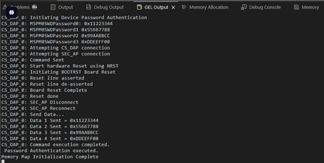

    Here's what I see:
    When you perform the password authentication, do you see this:
    Owen

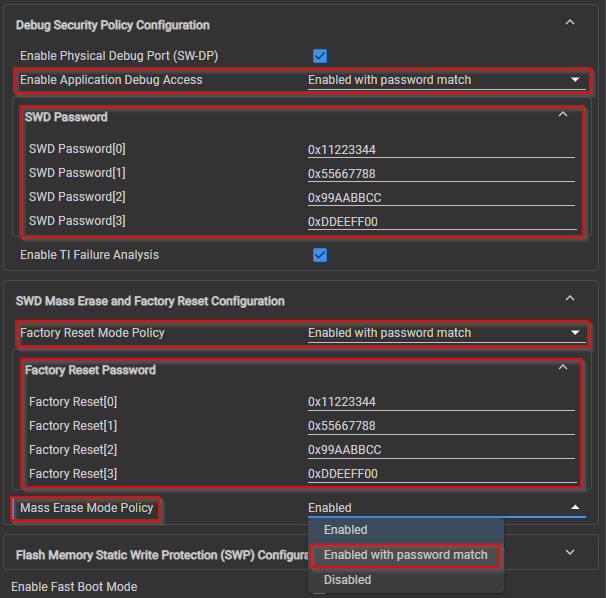

    For myself, I wrote a routine to update NVM NONMAIN memory myself on system bootup. And the BCRConfig bytes are dumped in my previous comment above. Let's to focus on the method that you provided and my test below. We go back to my problem afterward.
    I follow your method to make change in SYSCFG file below:
    1. From the memory, the SWD password was set to memory, but when my software dump the memory from device, it is still not modified.
    2. When I input the wrong password in ccxml, the debug process still can be started.
    3. During the start of debug process, I cannot get your output below.
    I just got the last sentence, "Memory Map Initialization Complete".

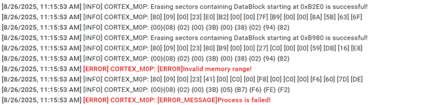

    4. This is the most important point. After enabled the BCR config, the hex generated has error on UniFlash when it was downloading to DUT through bootloader.
    It seems that the new BCR config is not really write to DUT during my test above. Please help to provide more info and step by step of your test.

  • Hi Alan,
    When you changed the password, were you able to successfully flash the device? After flashing, did you power cycle the board?
    How are you dumping memory? Are you doing this directly from CCS or Uniflash?
    After updating the .ccxml file, did you perform the password authentication? In CCS you can do it by right-clicking on the .ccxml file under TargetConfigs > Scripts > MSPM0L1106_Commands > MSPM0_Mailbox_DebugAccessPasswordAuthentication_Auto. This should update the password that is getting sent to the device and you won't be able to gain debug access with an incorrect password.
    The screenshot I sent was not from attempting to debug the device. The screenshot was the result of performing the password authentication script.
    Are you allowing for NONMAIN to be erased?

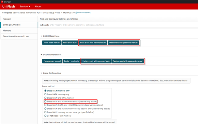

  • Hi Alan,
    I believe you can use Uniflash and CCS to perform Mass Erase with Password and Factory Reset with Password. See screenshots below:
    In the screenshot of Uniflash, ensure that the option to erase NONMAIN memory is selected. This can also be configured within the project properties in CCS. If you are not seeing changes to memory, this could be the explanation.

    Yes, I did. After selected MSPM0_Mailbox_DebugAccessPasswordAuthentication_Auto, there is nothing happened. If there is no password, the debug session will be pause at the main().
    Yes, I understand about this, but I didn't get this authentication operation.

  • Hi Owen,
    Can you tell me where to input the Mass erase and Factory reset password? I tried the buttons that you highlighted, it will not prompt for the password.

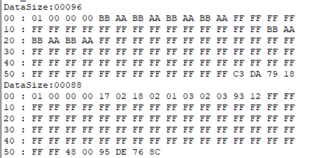

    2. Base on the above, I wrote an routine based on the gBCRConfig and gBSLConfig provided from sample code provided by CCS.
    3. I modified the BSL with password enabled, it works on UniFlash. Here I just want to show that the NONMAIN memory access is correct.
    4. With similar, I enabled mass erase and factory reset password, the operation failed. It is expected because I cannot find the way to input password in UniFlash. (Rmk: Debug Lock is enabled without password.)
    5. When I test with Debug Lock password enabled, both UniFlash and CCS cannot work already, even I modified the password in ccxml.

  • Hi Alan,
    The password should be input in the .ccxml file that you load into Uniflash.

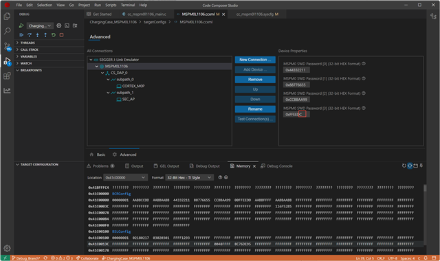

    Can you confirm that your NVM Configuration settings have Debug Access, Factory Reset, and Mass Erase all Enabled with password match?
    Try performing a Project-less Debug session in CCS. You can do this by right-clicking on the .ccxml file and clicking Start Project-less. Then follow the same steps to perform the command.
    Here is the screenshot you sent earlier:
    In this screenshot, it is important to note that your password is the reverse of the one I have been using as an example. Furthermore, the 4th double word is technically 0x00FFEEDD.
    If nothing above works, please try the following:
    1. Create a new empty project in CCS.
    2. In the SysConfig file, enable the NVM Configuration.
    3. Enable the Debug Access, Factory Reset, and/or Mass Erase with password match.
    4. Input the password for all of the options you selected. (Make them the same).
    5. Go to project properties> Debug > MSPM0 Flash Settings > select the Erase MAIN and NONMAIN memory (see warning above) option.
    6. Open the .ccxml file and input the password. (Advanced > click on the device name, i.e. MSPM0L1106 > under Device Properties input the password exactly the same as it was in SysConfig.
    7. Make sure everything is saved.

    1. Right-click on the .ccxml file
    2. Click on Start Project-less Debug
    3. Click on Scripts > MSPM0L1106_Commands
    4. Now perform any of the commands that require a password. (I recommend using the manual options. These will prompt you to press the reset button on the device or pull the reset line low).

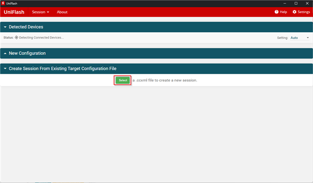

    If you want to continue using Uniflash:
    1. Open Uniflash
    2. Scroll down to the bottom to Create Session From Existing Target Configuration File and press Select
    3. Navigate to the file path that contains the .ccxml file that you updated earlier.
    4. Now attempt to perform the Factory reset/Mass erase with Password (I recommend the manual option).
