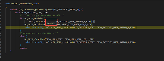

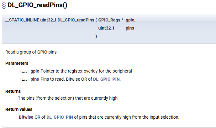

  I would like to ask about the usage of the DL_GPIO_readPins function.Are there any prerequisites for using it?
Why is it that when I add this function in the interrupt of the example, I can read the pin level and get a value,
but when I use it elsewhere, the value I read is always 0?

  • To read a pin, input has to be enabled on it, specifically the IOMUX INENA bit. In Driverlib, INENA is set only for a pin configured as a GPIO Input, and explicitly cleared for an Output.
    I haven't found a (Driverlib) mechanism for setting INENA for an Output pin.
    You'll probably have to set it yourself, using something like:
    > IOMUX->SECCFG.PINCM[GPIO_GRP_0_PIN_IOMUX] |= IOMUX_PINCM_INENA_ENABLE; // enable input as well
