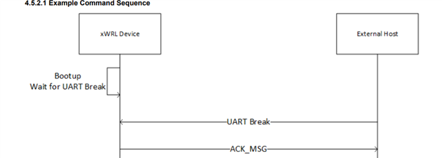

I am working on the G3507 board and need to generate a UART BREAK signal.
As I understand, the normal UART TX idles at 3.3V, so to generate a break I need to drive the TX line low for a certain duration (around 50 ms).
My intended approach is:
  1. Disable the UART peripheral.
  2. Reconfigure the UART TX pin as a GPIO output and drive it low.
  3. Maintain the low state for ~50 ms.
  4. Reconfigure the pin back to its default UART functionality and re-enable UART.
Could you please share example code or the recommended method to achieve this?
Where I need this I attached below, please refer
Thanks & Regards,
Amara Rakesh

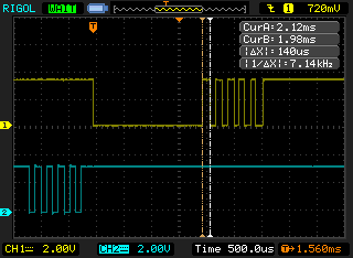

  • What is at the other end of the wire? (Presumably the agent that's producing the display.) I've seen UARTs that don't recognize Break but report it (along with a junk byte) as a Framing Error.
    I tried inserting your Method 1 (LIN) into a copy of "uart_echo_interrupts_standby", between the Receive and Transmit calls. I shortened the break time to 2ms (2x byte-times) and inserted a 10usec delay after the Break; these were to make the scope trace easier to read. [I also removed the SleepOnExit call and changed the LPM policy to SLEEP0.]
    I see the break and the echoed byte; I don't see a stray (properly framed) 0x00 byte:
    Neither Putty nor Teraterm see the break per se; I suppose that either they ignore it or it gets lost in the USB somewhere.
    The actual sequence:
            case DL_UART_MAIN_IIDX_RX:
                DL_GPIO_togglePins(GPIO_LEDS_PORT,
                    GPIO_LEDS_USER_LED_1_PIN | GPIO_LEDS_USER_TEST_PIN);
                gEchoData = DL_UART_Main_receiveData(UART_0_INST);
    #define SEND_BREAK 1
    #if SEND_BREAK
                DL_UART_enableLINSendBreak(UART_0_INST);
                delay_cycles(2*CPUCLK_FREQ/1000); // 2x character times at 9600bps
                DL_UART_disableLINSendBreak(UART_0_INST);
                delay_cycles(CPUCLK_FREQ/100000UL); // 10usec for the scope
    #endif // SEND_BREAK
                DL_UART_Main_transmitData(UART_0_INST, gEchoData);
                break;

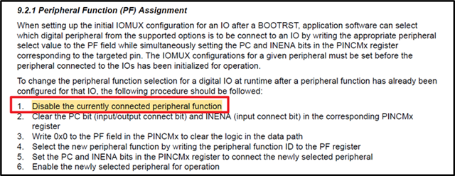

  • Hi Amara,
    Just want to mention that, must strictly follow the PF switching steps in the TRM as shown below. Disable the current IO function before changing the PF, otherwise, abnormal situations will occur.
    For example, if you want to switch the UART to GPIO, please follow the two steps as below to completely turn off UART and then switch PF filed to GPIO function.
    Peter
  • yeah peter, I faced unexpected behavior where the UART was not receiving data and the data index was shifting. After adding the disable code based on your reference, the code is now working as expected. My requirement was UART → GPIO → UART, and with your code reference I achieved it
        DL_UART_Main_disable(UART_1_INST);
        DL_UART_Main_disablePower(UART_1_INST);
