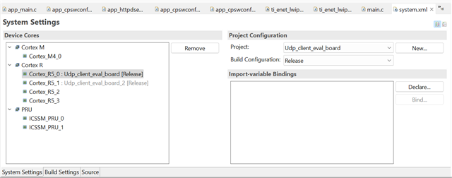

I took  ipc-notify example code and in that i just modified the project in system.xml.
so i configured like below

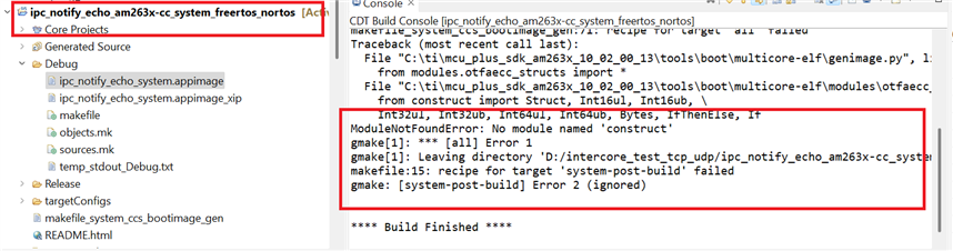

So i just built and flashed and i checked weather both project is working or not...but it is not building can u say how i can work with multi core project
1.  my requirement: i created 2 project name : udp_client_eval_board and udp_client_eval_board_2 so in this two
I need to put my udp_client_eval_board - r5fss0-0 in first core and
udp_client_eval_board - r5fss0-1 in second core.
so can you suggest how to approach this. Yours answer is mostly welcome.
