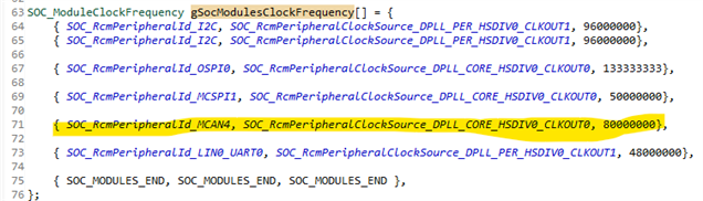

  • Hi Frank,
    The clock of MCAN module is configured by Module_clockSetFrequency() in ti_power_clock_config.c. The clock is defined in gSocModulesClockFrequency[] in the same file.
    If it is not configured, the default MCNA clock source is WUCPUCLK (25MHz), and the clock divider is 1.
    If the MCAN clock defined SocModulesClockFrequency[] is 80MHz, the 310Kbps baudrate is expected: 1000kbps * 80MHz/25MHz = 310kbps.
  • so what am I supposed to do now, to solve this?
    MCAN in application code is configured in ti_power_clock_config.c like in your image, and since this is a auto generated file, I cannot change it anyway. Also, adding MCAN to the SBL, does not change the observed behaviour. To me it feels like the SBL does some SOC configuration that is different from the GEL files.
  • Hi Frank,
    The ROM bootloader configures the core PLL only which are required during boot. The SBL reconfigures the core PLL and Peripheral PLL. The Core CLKOUT0 is 400MHz, and CLKOUT1 is 500MHz, the Per CLKOUT0 is 160MHz, and CLKOUT1 is 192MHz.
    If the MCAN is enabled (sysconfig), the MCAN clock is configured as 80MHz from CORE CLKOUT0. What is the MCAN clock config in your setup (power_clock_config.c)?
    Please double check the PLL settings (the registers are located at 0x5320_04xx).
  • The clock setup in application code on R5_0 looks like this:
    SOC_ModuleClockFrequency gSocModulesClockFrequency[] = {
        { SOC_RcmPeripheralId_I2C, SOC_RcmPeripheralClockSource_DPLL_PER_HSDIV0_CLKOUT1, 96000000},
        { SOC_RcmPeripheralId_MCAN1, SOC_RcmPeripheralClockSource_DPLL_CORE_HSDIV0_CLKOUT0, 80000000},
        { SOC_RcmPeripheralId_MCAN0, SOC_RcmPeripheralClockSource_DPLL_CORE_HSDIV0_CLKOUT0, 80000000},
        { SOC_RcmPeripheralId_OSPI0, SOC_RcmPeripheralClockSource_DPLL_CORE_HSDIV0_CLKOUT0, 133333333},
        { SOC_RcmPeripheralId_WDT0, SOC_RcmPeripheralClockSource_SYS_CLK, 200000000},
        { SOC_RcmPeripheralId_LIN0_UART0, SOC_RcmPeripheralClockSource_DPLL_PER_HSDIV0_CLKOUT1, 48000000},
        { SOC_MODULES_END, SOC_MODULES_END, SOC_MODULES_END },

  • The TI OSPI SBL example reconfigures the Core PLL and Peripheral PLL. The Core CLKOUT0 is 400MHz, and CLKOUT1 is 500MHz, the Per CLKOUT0 is 160MHz, and CLKOUT1 is 192MHz.
    SOC_RcmPeripheralClockSource_DPLL_CORE_HSDIV0_CLKOUT0 is used in your setup for MCAN0 and MCAN1, the divider should be 400MHz/80MHz = 5. Can you check if the MCAN divider register is programmed with a right divider?
    MSS_RCM_MCAN0_CLK_SRC_SEL at 0x53208100
    MSS_RCM_MCAN0_CLK_DIV_VAL at 0x53208300

    This means that the XTALCLK (25MHz) is used for MCAN modules for OSPI mode.
    For DEV mode, the clock source is 0x4 (DPLL_CORE_HSDIV0_ CLKOUT0, 400MHz), and the divider is 0x5 (4+1), so the MCNA function clock is 400/5=80MHz.
