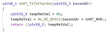

The UART example "uart_echo_low_latency_polling" use the function of "UART_getCharFifo".
The function is defined in "/source/drivers/uart/v0/lld/uart_v0.lld.c".
It seems that the function discard received RX data with ALL RX error.
(The function "UART_readByte" we cannot access is the same.)
I think some modification is needed.

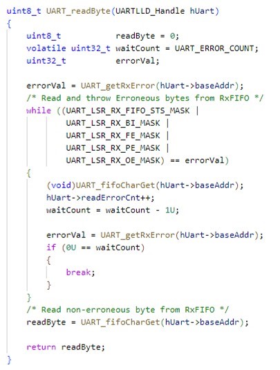

  • Hi Shaunak Deshpande,
    I am sorry not to explain my question in detail.
    I had no error in performing the UART examples because normally RX errors do not occur.
    I am pointing out the LLD function with RX error handling.
    The function "UART_fifoCharGet" read 1 byte from RX fifo simply.
    And the funcion "UART_readByte" read 1 byte after discarding RX data with RX errors.
    I thought the function should discard RX data with ANY RX error but actually the function discard RX data only with ALL RX errors.
    (In order to perform the statements in "while", All RX errors must be issued.)
    The function "UART_getCharFifo" read 1 byte from RX fifo with changing LCR temporarily and checking RX errors.
    This function also discard RX data only with ALL RX errors.

  • Hi Jeeuk,
    Thanks for the explanation,
    Looking at the UART_readByte and UART_getCharFifo functions, you're partially correct in your analysis, but there's an important detail about the error checking.
    In UART_readByte (lines 1058-1086), the code checks for errors with this condition:
    while ((UART_LSR_RX_FIFO_STS_MASK |
    UART_LSR_RX_BI_MASK |
    UART_LSR_RX_FE_MASK |
    UART_LSR_RX_PE_MASK |
    UART_LSR_RX_OE_MASK) == errorVal)
    This is checking if errorVal equals ALL error flags combined. You're right that this would only discard bytes if all possible RX errors occur simultaneously (break error, framing error, parity error, and overrun error), which is unlikely.
    However, looking at UART_procLineStatusErr (lines 2617-2694), there's additional error handling. This function is called when line status errors are detected, and it specifically checks for individual error types:
    if ((lineStatus & UART_BREAK_DETECTED_ERROR) != 0U)
    hUart->readTrans.status = UART_TRANSFER_STATUS_ERROR_BI;
    hUart->readErrorCnt++;
    else if ((lineStatus & UART_FRAMING_ERROR) != 0U)
    hUart->readTrans.status = UART_TRANSFER_STATUS_ERROR_FE;
    else if ((lineStatus & UART_PARITY_ERROR) != 0U)
    hUart->readTrans.status = UART_TRANSFER_STATUS_ERROR_PE;
    else
    hUart->readTrans.status = UART_TRANSFER_STATUS_ERROR_OE;
    This function is called by the interrupt handler (UART_lld_controllerIsr) when line status errors are detected.
    So while the specific byte reading functions you mentioned may only discard bytes with all error types simultaneously (which appears to be a bug), the driver does handle individual errors properly at the interrupt level through UART_procLineStatusErr.
    To properly handle individual errors in UART_readByte and UART_getCharFifo, the condition should check for ANY error (with a bitwise OR operation) rather than requiring ALL errors to match.
    Let me raise a bug internally and get the implementation reviewed by our driver experts.
    Shaunak
  • I have raised a bug internally for review: https://jira.itg.ti.com/browse/MCUSDK-14895

  • Hi Jeeuk,
    Apologies that you had to face this bug, I have initiated a discussion with the team to get the resolution for this bug. This will be fixed in the next SDK release on ti.com and the fix will also be available soon via GitHub TI SDK (before the ti.com official release)
    Shaunak
