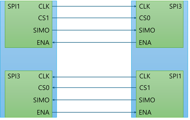

Hi, Ti,
I want to use SPI Master and Slave with DMA.
For this, I desigend SPI1 Master only and SPI3 Slave only.
Master function is no problem, but SPI3 Slave only function, it has a problem.
I intented to this function  should be working without tx dummy, because some examples from e2e I couldn't see dummy tx.
so I need you cofirm my codes attatche.
Also here is my H/W connection. additionally I'm not using ENA control signal.

void SpiCommTest(void)
    spiInit();
    SpiCommInit();
    if(bFlag == TRUE)
		 while(1)
			 for (uint32 i = 0; i < nLen; ++i)
				 g_aTxData[i] = (uint8)(i & 0xFFU);
			Spi1TxSend(g_aTxData, nLen);
			for (uint32 j = 0; j < 0x2000000; j++);
    else
//    	while(1)
    		Spi3RxReady(nLen);
//			for (uint32 j = 0; j < 0x2000000; j++);
 		(void)Spi3TxDummy(g_aTxData, nLen);
 		Spi3RxFinalize(g_aRxData, nLen);
    while(1);
    return;
