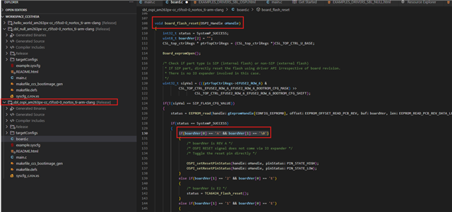

Just got 5 new TMDSCNCD263P  PROC159B eval boards.
Using Uniflash 9.2.0.5300, unit in DEVBOOT bootmode.
No feature works with RevB board, but works fine with Rev E2 and A boards. Can't program any image to flash.  And can't erase flash using utilities.
Does this version of uniflash support Rev B?  The flash reset depends on translating the version string from EEPROM = "B".
Current SDK 10.2.0.15 SBL images don't seem to support Rev B boards yet.

[8/25/2025, 11:34:14 PM] [INFO] Cortex_R5_0: Writing 1 chunk at offset 0x0
[8/25/2025, 11:34:34 PM] [ERROR] Cortex_R5_0: Run failed...
[8/25/2025, 11:34:34 PM] [ERROR] Cortex_R5_0: File Loader: Failed to terminate flash programming: Timed out waiting for target to halt while executing am263px_cc_flasher.out
