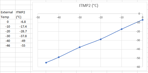

  • Hi QJ,
    Thank you for the fast reply.
    Here are some additional readings that we have collected:
    For now we have only collected data for temperatures up to 0°C. This data is shown in the attached picture.
    • in the far left column you can see the external temperature (at some temperatures we switched on the devices several times, so the first one at each temperature is the most valid one)
    • ITMP1-3 refers to the internal sensors. "raw" values are direct ADC readouts. The scaled values to "K" and "°C" have already been corrected using the calibration values.
    • ITMPx-ITMPx shows the difference between each sensor, which should not exceed 5°C with an absolute accuracy of +/-2,5°C for each sensor.
    • XTMP1-4 shows some additional external I2C sensors on the board for reference ( We only read data from the external sensors once the software has started up correctly)
    • The columns T/U/V on the far right show the difference to the external temperature readings
    From -46°C to -0°C the temperature difference of Sensor 2 is getting better, but is still not within the expected range of 2,5°C. There seems to be a linear relationship.
    It is also noticeable that only Sensor 2 drifts below the external reference temperature, while the other 2 Sensors tend to drift above the reference temperature.
    Thank you and best regards,
    Max

  • Hi Max,
    Is it acceptable for you to use your own calibration data instead of OTP value for sensor 2? From the Chamber Temp - ITMP2 chart (using your test data), the sensor 2 looks ok (linear chart).
