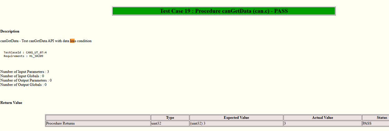

  • Hi Julian,
    The test report in the folder of "..\SafeTI-HALCoGen-CSP\TMS570LS12x_11x_v04.07.01\HALCoGen\TMS570LS12x\CSP\Test\Reports\Regression Reports' shows that the test passed:
    CAN1_UT.thr.htm
  • Yes, I am aware. But I cannot reproduce it, even with a vanilla HALCoGen config. Just to clarify, the mere interrupt arrival with an empty handler will not clear the newDat, only resetting it (e.g. using canGetData) will. Correct? Thats how I understand the test case. How can my vanilla config diverge from the one used by the CSP creators? I will do a diff on the sample dil files and see if that reveals anything. But I am not optimistic to find anything and really wonder whats going on here. Particularly since you were able to reproduce the issue on your end.
