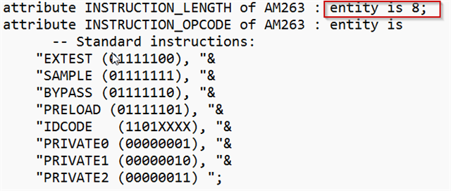

AM2634: Issue running boundary scan test
Part Number: AM2634
Other Parts Discussed in Thread: AM263P4
I have the same issues that were referenced but not resolved on another thread on this forum ( AM2632: ARM-Based MCU Can't Enter Boundary Scan Mode Using The AM263.bsdl ).
The supplied BSDL file for this device (AM2634CODFHAZCZR) specifies an 8 bit instruction register but when we capture the value of that register it only returns four bits.
We have also seen that the IDCode returned from the device has both a different version and part number value when compared to the value specified in the BSDL file.
As suggested in the previous thread we have tried different boot modes, and seen different behaviours.  The behaviour described above was seen with bootmode 0110.  When we tried with 1001, suggested in the other thread, we got no data returned from the chain.  Neither of these boot modes is referenced in the TRM for the device.
Many thanks
Stuart
  • Hi Stuart,
    Apologies for the long delay!! The bsdl present in ti.com has some errors.
    Please find the updated AM263.bsdl -
    Can you please help us understand the testcase how this instruction register value is being read. Can you share the test or the steps used to read instruction reg value.

    We read the instruction register by moving through the JTAG state machine to IR Capture and then IR Shift.  We clock a marker into TDI and monitor TDO to see when that marker is clocked out.  We see that there are 8 TCKs required to read out the marker which is how we know that the IR is 8 bits wide, rather than the four bits listed in the file.

    The COMPLIANCE was not working because the global checkers were fail as those pins are having boundary scan registers.
    In the file as well it is listed as 8 right?

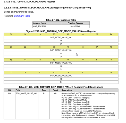

    Fortunately the board I am working on has DIP switches to configure the values of these pins.  We have tried the suggested values but see the behaviour previously described.
    Can you please put set the DIP switches in 1001 states and confirm it by connecting to R5F Core0 and reading the value of MSS_TOPRCM_SOP_MODE_VALUE register.

    The IR length in the file is not what we are seeing on the board.
    As you have highlighted the BSDL file specifies an 8 bit register; however we are seeing only four bits between TDI and TDO when we are running our tests.

  • The register MSS_TOPRCM_SOP_MODE_VALUE value for setting the DIP switches in 1001 states is 0110 (0x06) as shown in the below figure.

    DFT engineer measured the Instruction Register (IR) length using the JTAG TAP controller.
    • Device is powered up in sop1 mode
    • The TAP was reset and taken through the states:
    Test-Logic-Reset → Run-Test/Idle → Select-DR-Scan → Select-IR-Scan → Capture-IR → Shift-IR.
    • In Shift-IR, we applied a known bit sequence (1010…) on TDI.
    • The same sequence appeared on TDO after 8 TCK cycles.
    This confirms that the IR length of the device is 8 bits and the same is mentioned in the bsdl file as well
