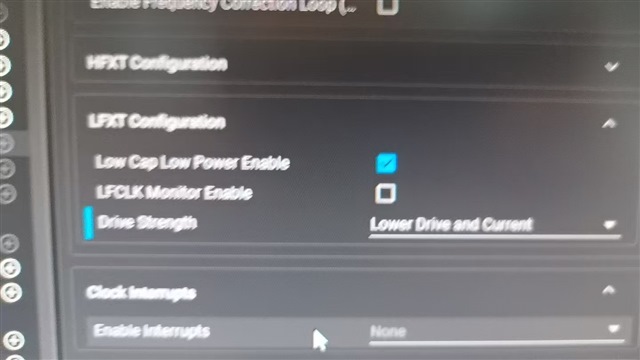

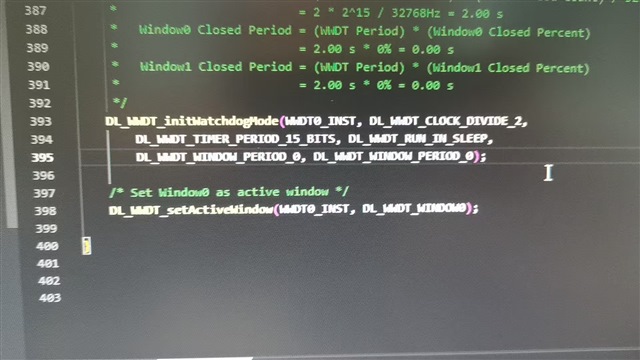

Customer needs to use WWDT in STANDBY0 power mode, but cannot configure the function properly with sysconfig. As they test, the WWDT can be configured properly in Run mode, but not in STANDBY0 mode.
please see the sysconfig generated code below:
Seems the 32k LFCLK cannot be configured properly in STANDBY0 mode, once check the below box, there is no change in generated code.
is there any manual configuration workaround the make WWDT in STANDBY0 mode work?
